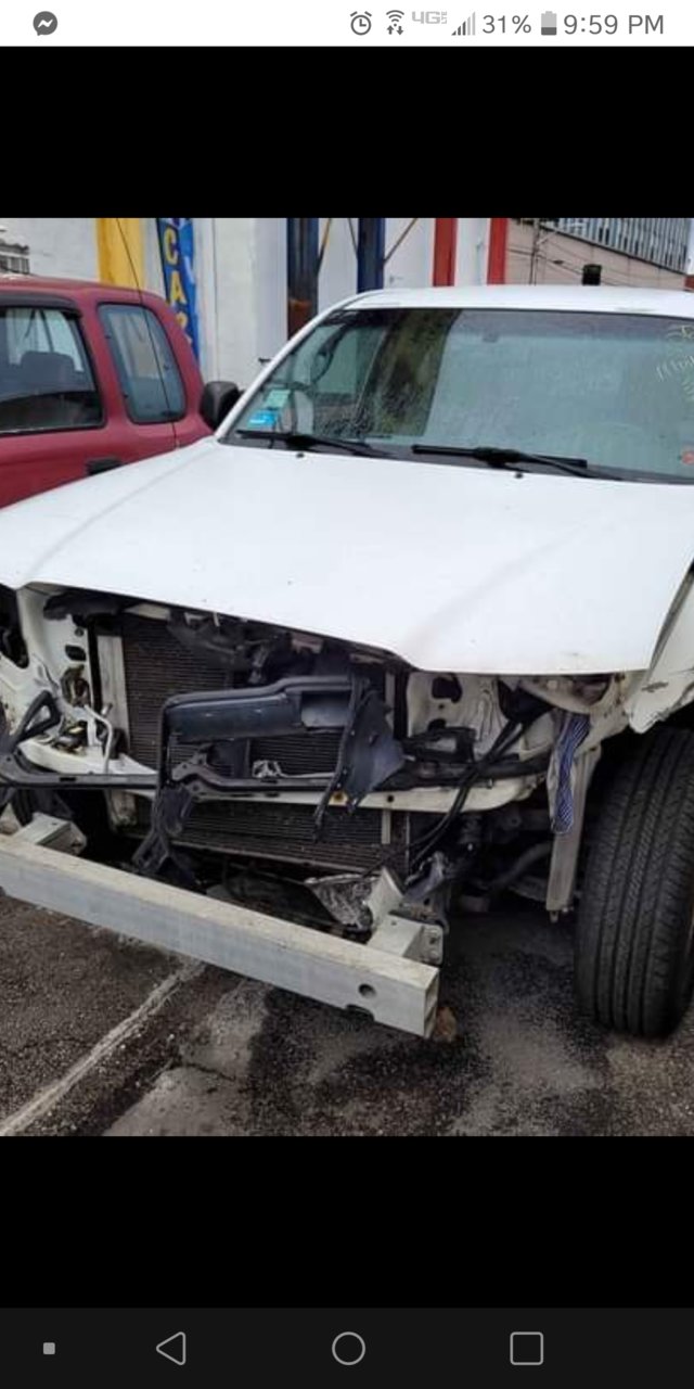

    So this is the damage. Surprisingly it still runs. The rad is bent, but not leaking. The fan is broke off the pulley it's attached to. There didn't seem to be any damages to the front of the block. Couldn't hear anything wrong coming from behind the timing chain cover.
    It still worries me that something got fucked in that whole timing chain area. There's no way the fan broke off and didn't fuck up anything else.
    Hence the reason I don't want to pay anymore than 500 or 600 bucks for the motor. At that cost, I can throw some money at it and not get close to the cost of a reman block, or another running junkyard motor.

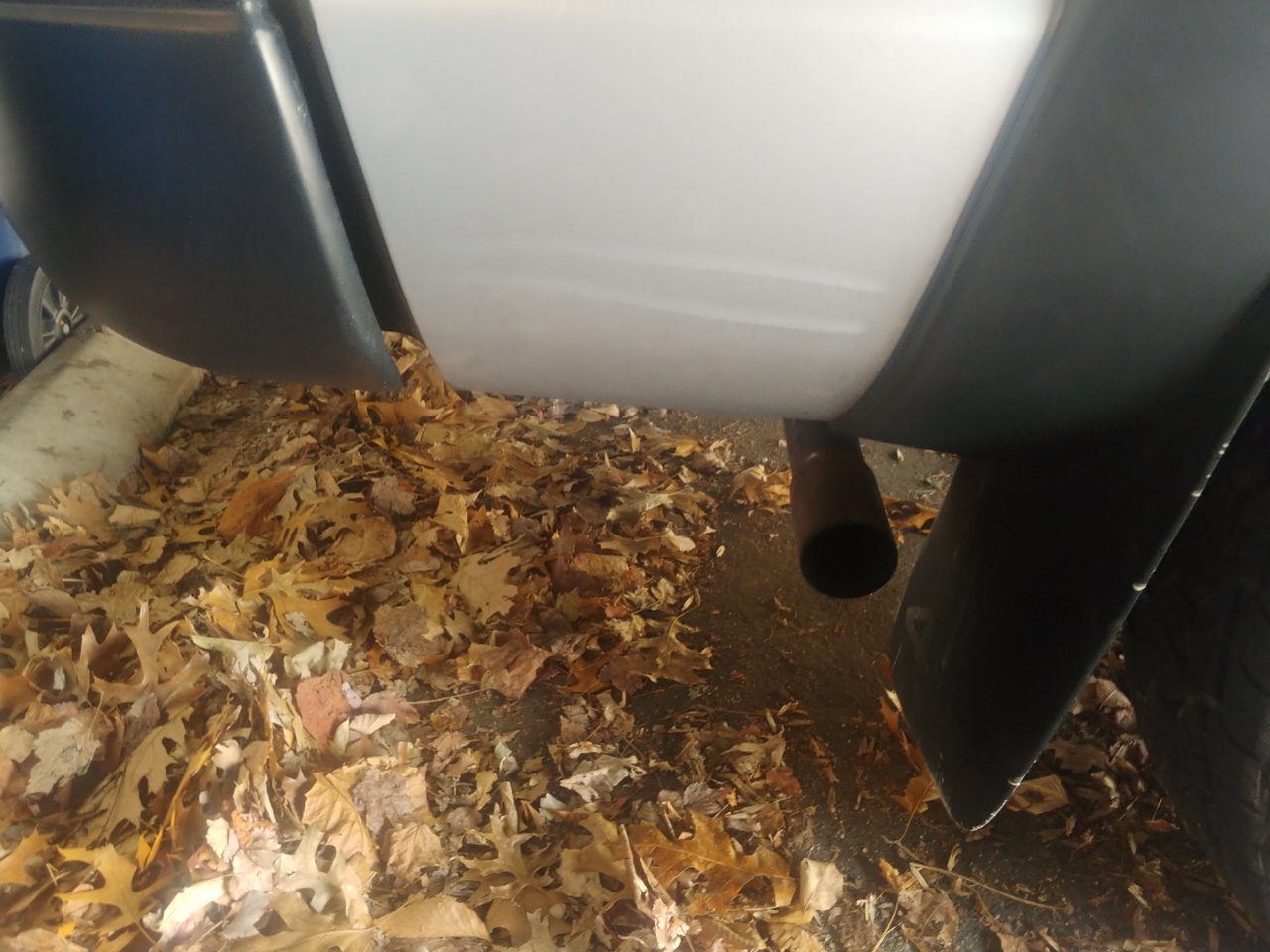

    This is the buildup after 260 miles. Still there, but significantly less than before. So it's still burning, but not nearly as much

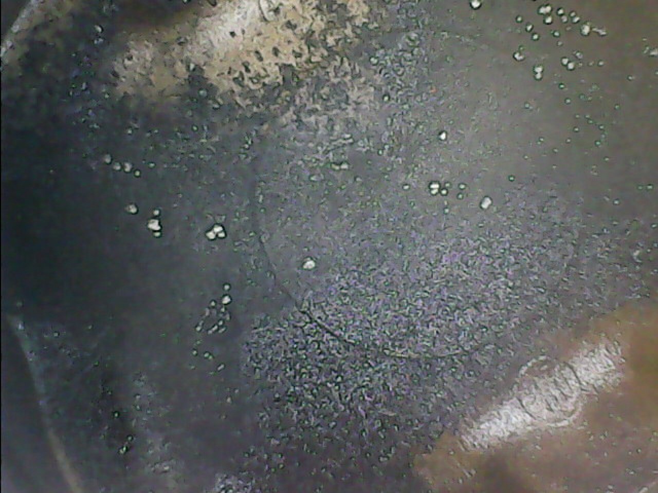

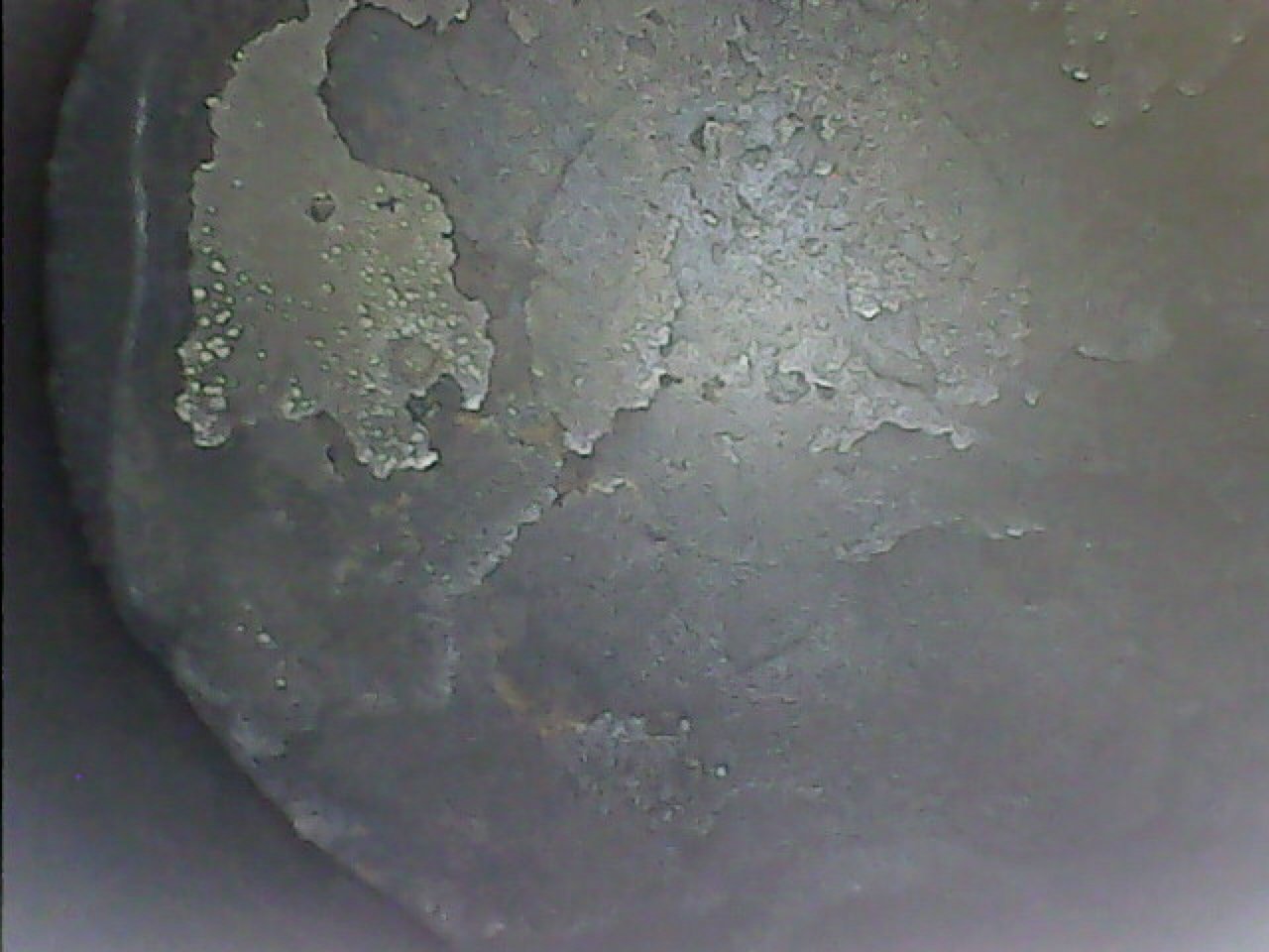

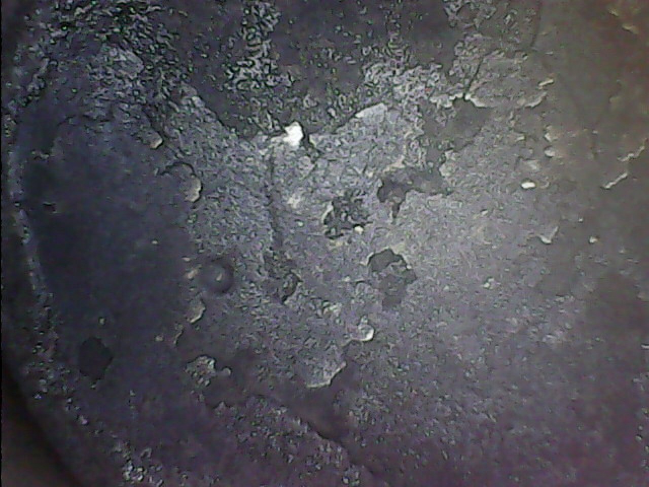

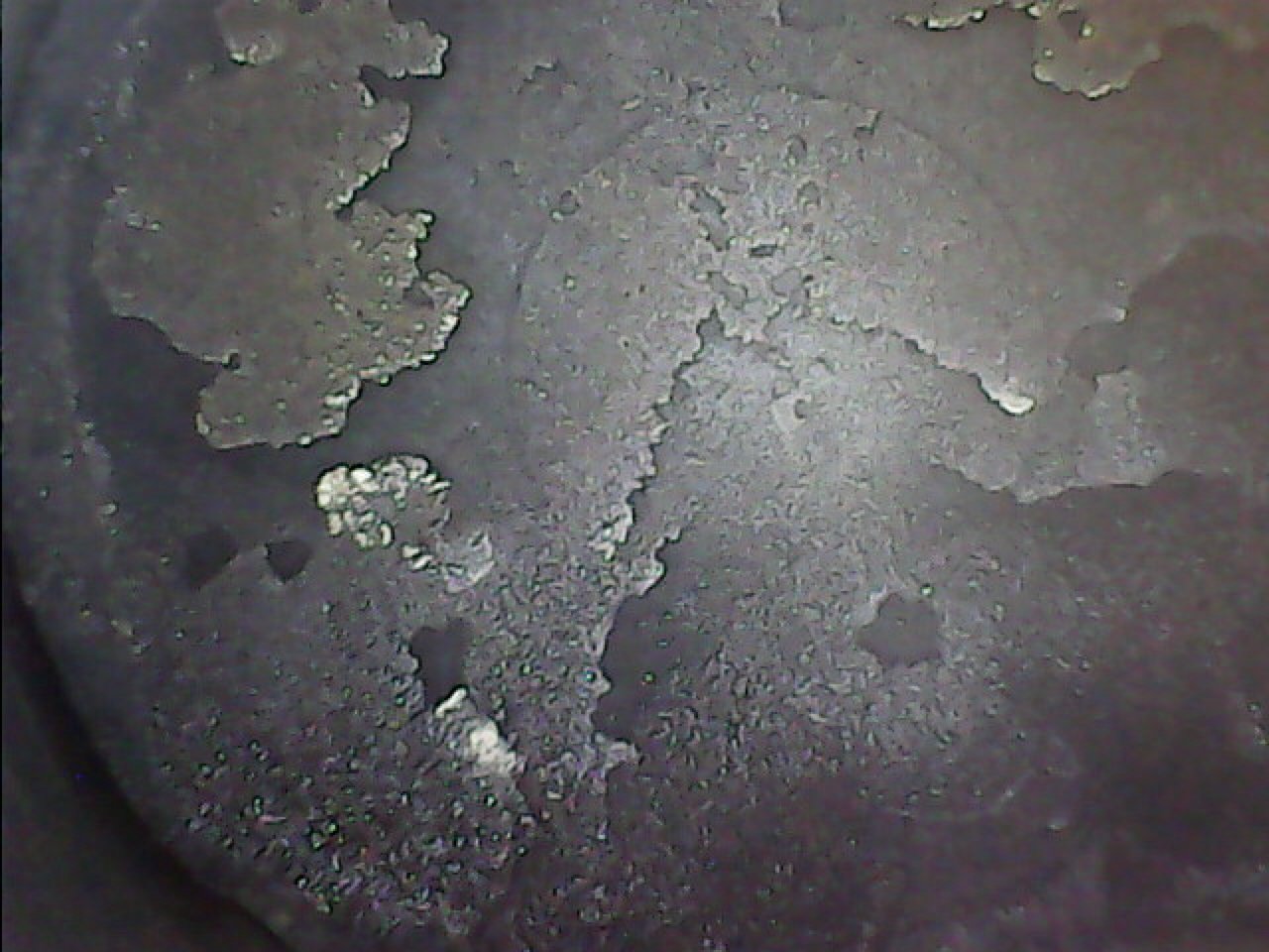

    Cyl 1,2,3,4 if it loaded them correctly. Gonna drop some more seafoam in and let it sit overnight. At least in cyl 1 and 2
