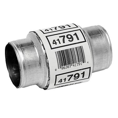

    How about a coupler? Same price as the other one.

    Hm I've never seen one of those before. I'm sure that would get the job done as well.
    I would have to get a 2.5" to couple two 2.25" tubes, correct?

    I'd just cut a piece of paper around each fitting to get the size. Then tape the ends closed so you have a circle.(like fitting Ring size)Take it with you to Napa and they can find you the correct one.

    If your pipe is 2.25 O.D. then buy a 2.25 I.D. coupler and two 2.25 exhaust clamps. $10-$15.

    Okay perfect. I think that's what I will do
