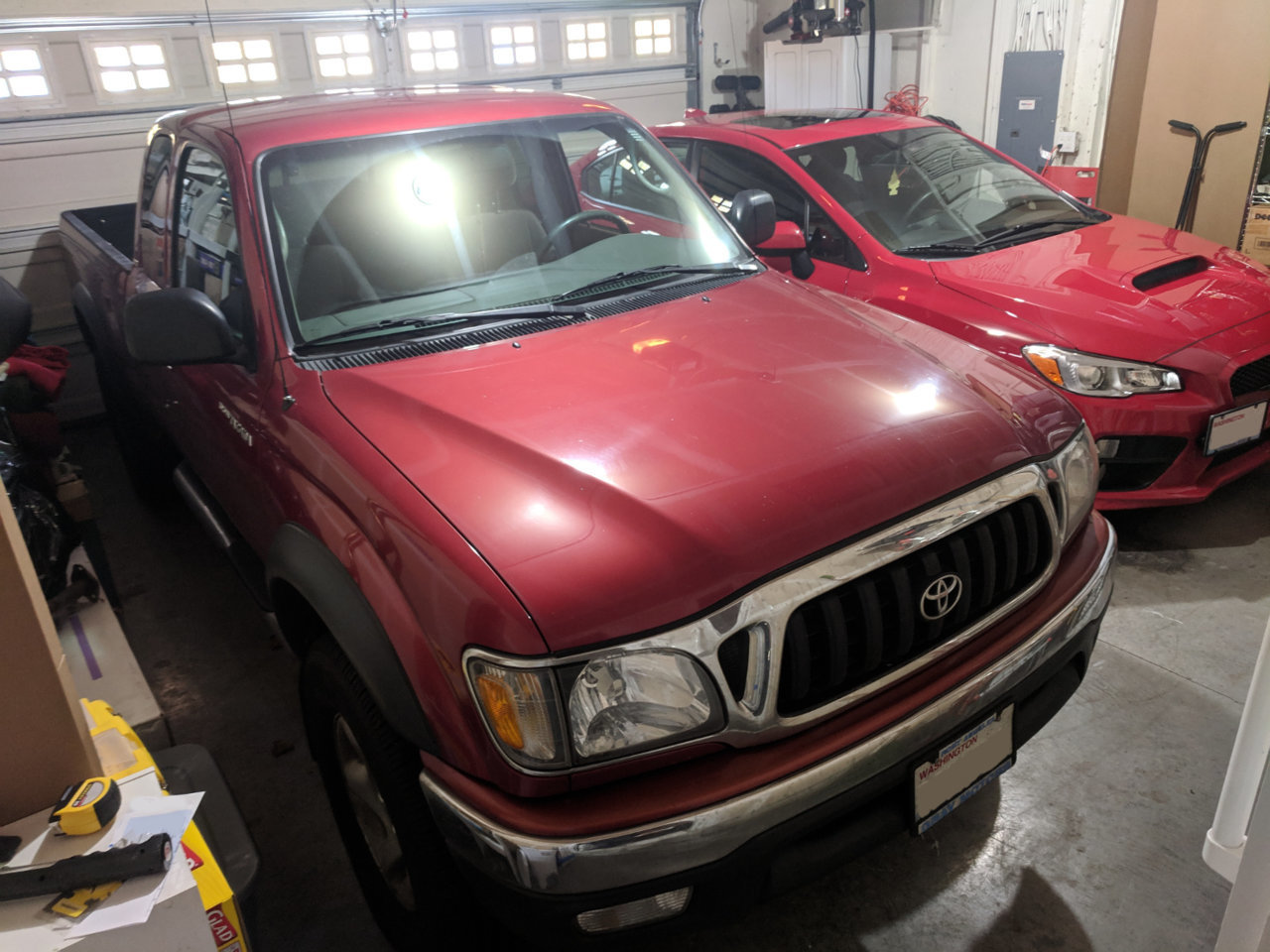

    Thank you! I will explore these options and see if this is something I can accomplish on my own or if I'll just get a shop to do it. I did the lowering springs on my Subaru by myself (omg manual spring compression tools a BITCH) so I could be handy enough. Pic time!
