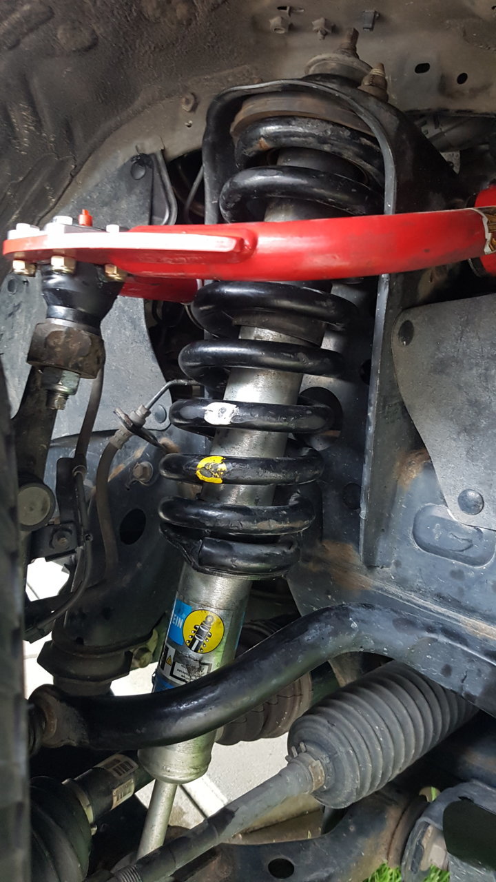

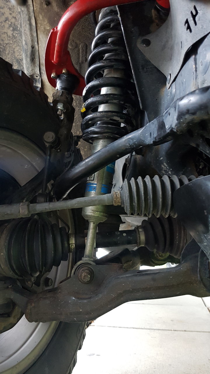

    Pics of suspension parts

    20180503_193112.jpg 20180503_193059.jpg Got pics of passenger side, drivers is the same.

    That looks like the stock coils to me.

    They are, 2 posts above pics i swapped back to stock coils at 25 on 5100s to compare rated vs actual lift.

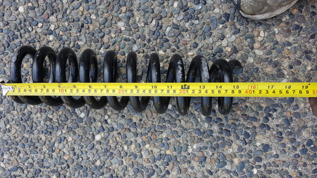

    I emailed arb monday, they said to remove and measure the springs. They are the correct length so im out of luck

    I’ll assume the same for me. I’m not interested in removing the springs just to measure them, so I’ll just find different springs that hopefully work as advertised.
