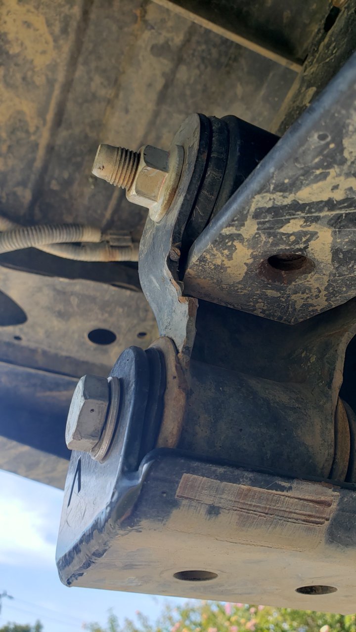

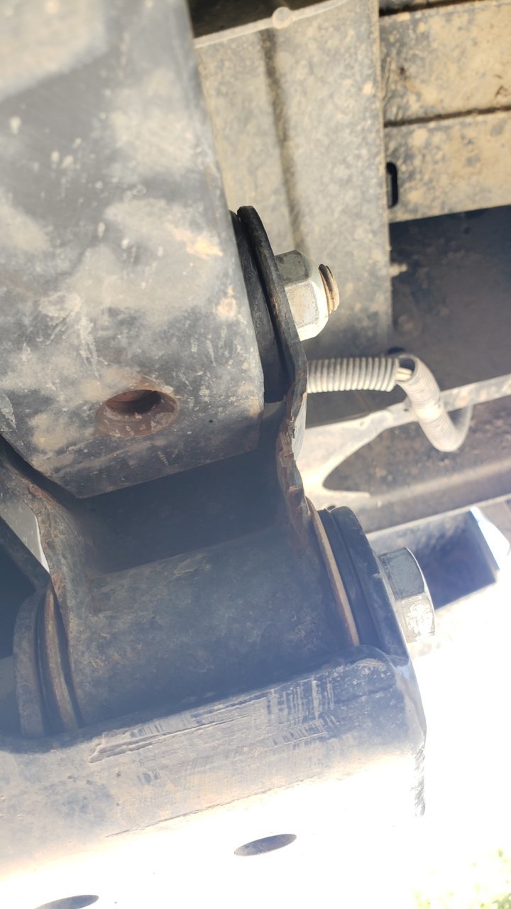

    pictures are taken with truck on level ground. that leaf that goes deep into the shackle is what I have to cut right?

    IIRC its the second leaf down, obviously dont touch the very top one connecting the pack to the shackle. I Tried to bob mine, didnt work but stopped most of my rub besides heavy flexing. I will be doing rago shackle hangers soon and will cut it. Most people cut halfway into the anti squeak pad. Or do what this guy did.
