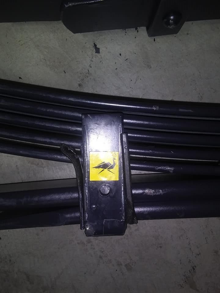

    This one already breaking off.. lol.
  3. Jun 17, 2020 at 11:04 AM
    HeadStrong Off-Road
    HeadStrong Off-Road [OP] Well-Known Member Vendor
    May 28, 2015
    #156242
    4,034
    2011 Toyota Tacoma and 2019 4Runner
    Yep that is how it came. Most packs will experience this issue.

    Just got mine yesterday! Thanks for the fast shipping!! If the plastic clip looks like the above picture does it need to be replaced or are they fine like that? Thanks! @HeadStrong Off-Road
  19. Jun 18, 2020 at 2:00 PM
    #19
    HeadStrong Off-Road
    May 28, 2015
    #156242
    4,034
    You are more than welcome we try to do what we can. you can replace them if you'd like but chances are they will break and fall off again

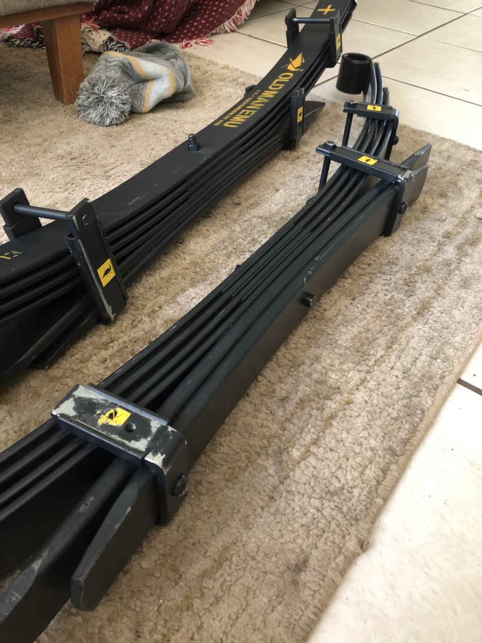

    Shame on ARB/OME. If you are even entertaining the idea of replacement leaf packs...buy a different brand. ARB is not the name you once knew.
    I am in the process of installing an add a leaf to the Dakars and only had ONE isolator sent to me (ordered a pair because who only orders one AAL? looking at you @HeadStrong Off-Road){UPDATE: Headstrong NOT at fault. They didn't stock them at the time} AND because my leaf pack is older, the original isolators are thinner than the new ones. I am now in the process of fabricating my own. They are mild steel and any decent hardware store has sheet metal for less than $10 because you damn well know ARB will charge you an arm and a leg for just one! You will need 4x per HD pack and 3 for standard packs. They go between the long leafs, not the over load.
    The new pads are GARBAGE and do not fit properly (too wide for some leafs) and SPIN/SLIP in the mounting hole...and the WORST part, they do not have have the grooves for grease and they are STUPID EXPENSIVE for what they are. But this is how ARB does business.... "Hey we changed our design and tough shit if you need the correct parts because we don't care." Talking to their customer support?? A DMV visit is less frustrating.
    Livid is an understatement. I ordered everything through Headstrong and please continue to support the local vendors and direct all the venom back towards the manufacturers.
    Wanna see how big of a piece of shit these leaf packs are?? This in DRY Southern California, no salt...after a little more than a year and NO ABUSE, they have been off road but talking fire roads and dirt lots... "off road". They haven't seen whoops, John Bull or Rubicon trails. You can see where they are rubbing and that's WITH the isolators/greased cushions. Bullshit, save yourself a headache instead of a few bucks by going with ARB. Cannot wait to ditch ARB and move onto better products.
