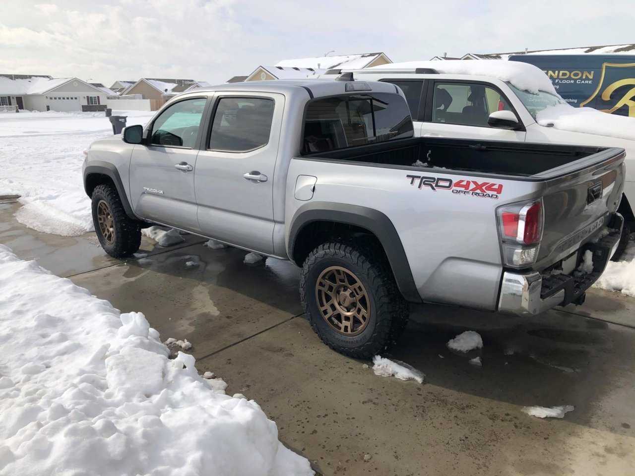

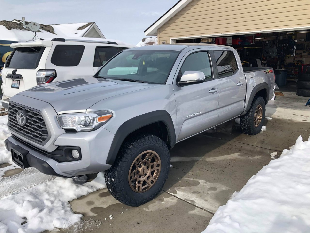

    Unknown man. Unfortunately. Oltahe took them back but they were hesitant to send another set from their current batch, as they did not know how widespread the problem was. They were working with Toyota. Historically there have been no issues with that wheel, but who knows where the set on Amazon came from and when they were produced. I took a refund at this time. I went ahead and placed another order for a set of the same OEM TRD wheels in Matte Bronze from another dealer. My hope is that another dealer's batch and another color wont have the same problem. They are out for delivery today, so we will see. I actually wanted matte bronze to begin with, but was too chicken to order. I took this as a sign or go ahead. I will let you know tomorrow if there are still issues....

    New set of matte bronze wheels are going on without issue today!
