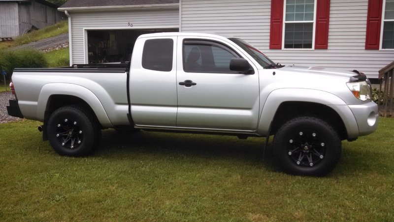

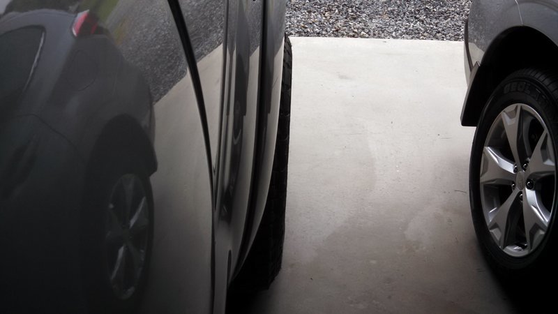

    Hi I might be able to help shed some light also. 265/75/16 Hankooks on a 09 with Ballistic Jesters 16x8 Bilsteins 5100 all the way around set at 1.75 on front. I rub on mud guards. Next time I will go back to 265/70/16 to keep from rubbing. And on the rims go to ebay and check out CWO Custom Wheel Outlet reasonable prices. View from drivers side to rear with a little sticking out. Here's a link. They have a calculator for fitment.
    Here's a link.
    4-NEW ION 133 16x8 6x139.7 -5mm Black Wheels Rims[​IMG]
