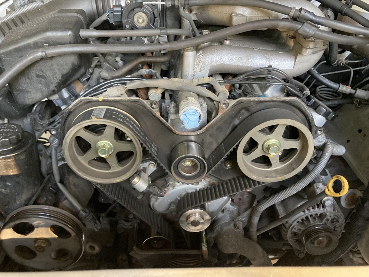

    Status update:
    Here is a list of what I was able to accomplish thanks to the TW forum and Youtube, debrief on pain points are at the bottom:
    Mileage at 202,352 miles.
    Timing belt
    Camshaft seals x2
    Crankshaft seals x1
    Water Pump (no special sealant) and seal
    Thermostat and seal
    P/S Belt
    A/C Belt
    Alternator Belt
    Tensioner
    Idle pulleys (two I think?)
    Crankshaft Bolt
    Crankshaft gear (broke a tooth extracting)
    Tensioner bolts.
    Thermostat (jiggler valve @ 6:00 position)
    Pain Points:
    • When removing the pulleys, ensure you have the appropriate M6 x 100mm bolts to attach to the related extractors (I rented from Autozone) and/or crankshaft gear. I broke a tooth on the crankshaft gear thinking I could get away with it. WRONG. This took a couple trips to Home Depot.
    • Ensure the timing belt is installed without the tensioner installed yet, this makes the belt installing easier. I installed the tensioner hand tight before lining up the timing belt. This was a time consuming mistake. Lesson learned. Once the belt is routed correctly, proceed to install tensioner to spec, and then give the belt a couple rotations to ensure timing is correct (I did maybe 5/6 cycles)
    • Consider replacing the tensioner bolts. I lucked out and removed the two bolts, but was left with a rounded bolt head. Advance Auto Parts had a replacement set in the store.

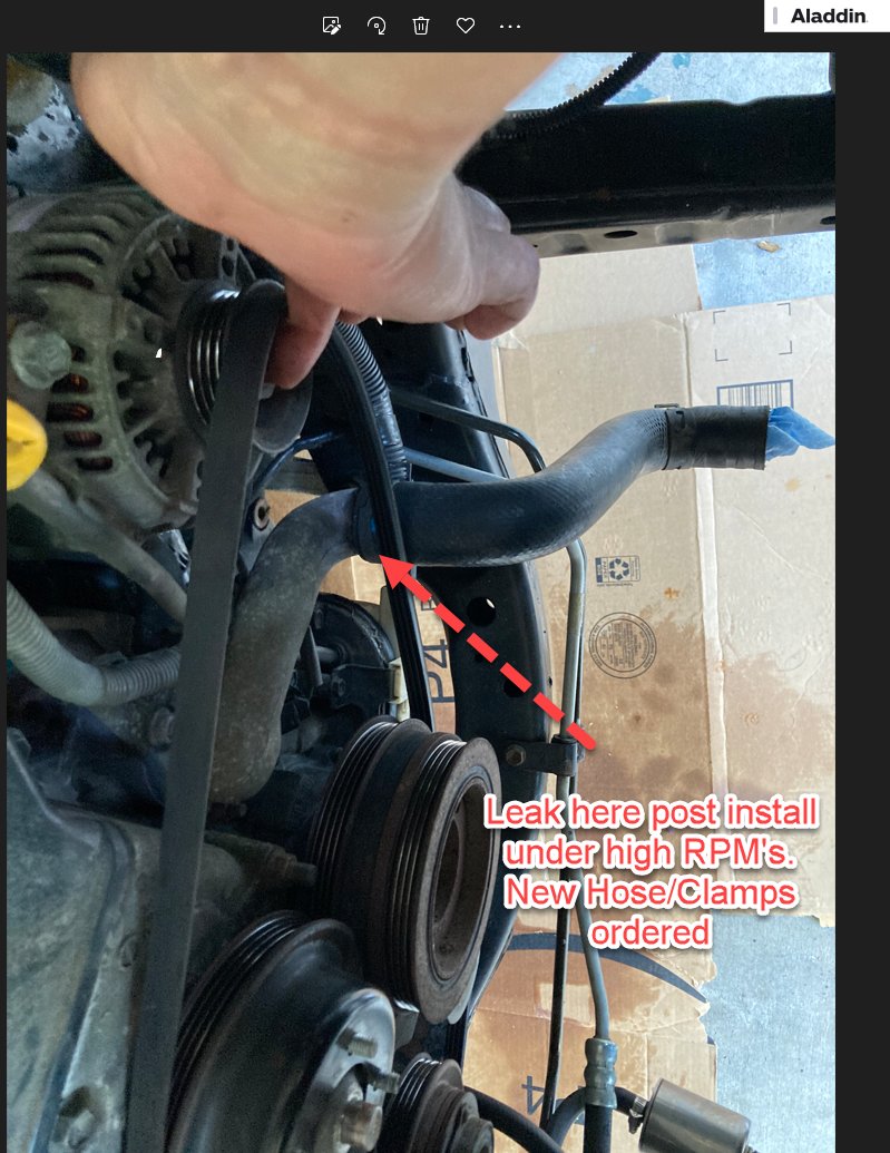

    One item I noticed is that I now have a slight coolant leak on my lower radiator hose, at the thermostat inlet, see pic. I figure this is due to new water pump thermostat having more pressure that the old clamp/hose cannot handle. I intend replace the hose and clamps, and maybe clean up the male end of the inlet nearest to the thermostat.

    Pics are PRE install, and NOT a representation of actual TDC.
    Hope this helps future DIY'ers.

    A bit of advice for the coolant hoses. Go with OEM. I tried to save a few bucks and bought Gates and Dayco and neither fits well to the point where I wouldn't trust them.
