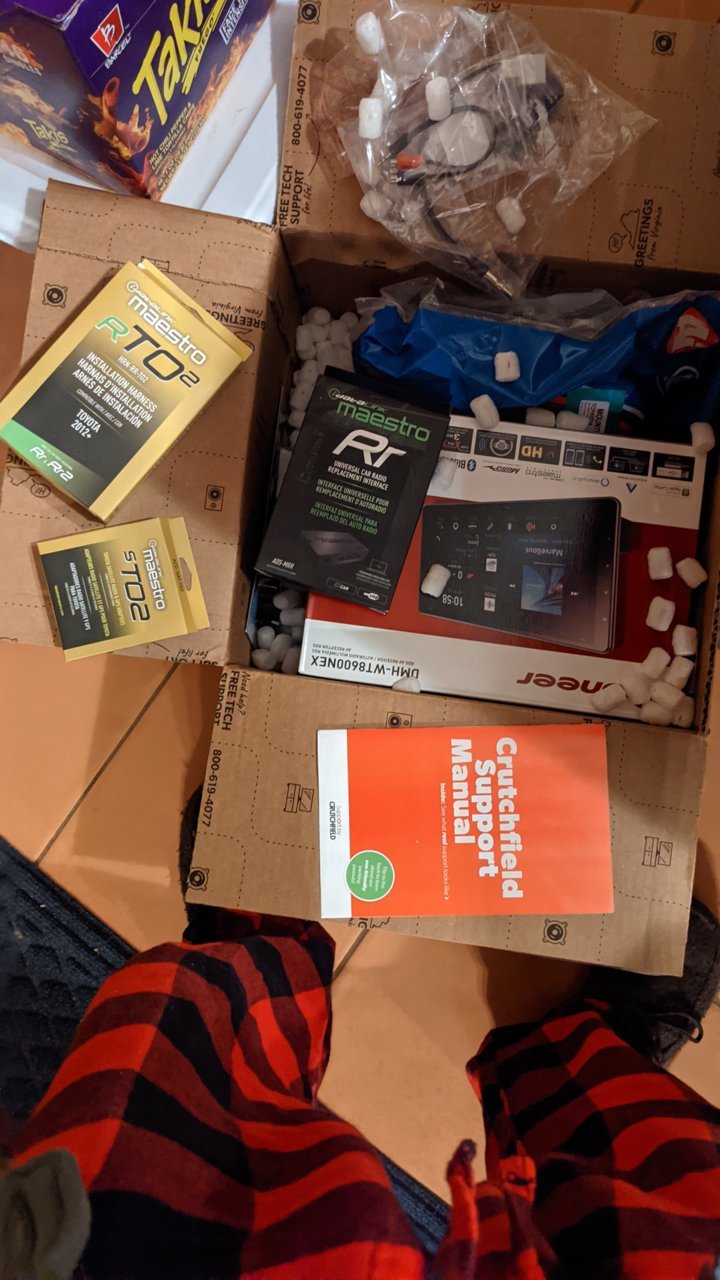

    Bit the bullet last night and ordered the 8600 last night along with all the fixings. Also ordered the mic to replace the factory mic from enfig so I don't have any random mics just hanging out.
    Got a call from the dude at enfigcarstereo.com saying that now he sells a tacoma specific model, but he doesn't have it listed on the website yet. He changed my order and now I'm getting the microphone with the tacoma specific housing. Gotta say, I was pleasantly surprised by customer service that good from a site like that. Asked him when it would be put up on the website, and he told me that it would be during his site overhaul, which would be soon. So for now, if you want to get that microphone from him, I would say call them.
    Still waiting for crutchfield to ship my order, and the guy at enfig said it would be in the mail tomorrow morning. Hoping to get all the hardware sometime this week, and installing it before I have to do a cross country drive next week.
    EDIT: Including the items in my cart from crutchfield, so that people can take a look.
    Pioneer DMH-WT8600NEX
    iDatalink ACC-SAT-TO2 (NOTE: the recommended accessory pack from crutchfield DID NOT include this GPS cable, had to look it up on the idatalink website)
    American International TOYK9714 Dash Kit
    Crutchfield RCA Adapter
    Metra 40-LX11 Antenna Adapter
    Metra AX-TOYUSB USB Port Cable
    iDatalink Maestro RR Interface Module
    iDatalink HRN-RR-TO2 Factory Integration Adapter
    From enfigcarstereo.com
    ENFIG_MIC_VW1_WITHCONVERTER, which the guy called me about to change to the tacoma specific model that is currently unlisted, but if you call you can buy it like that.
    EDIT: It has apparently been added to the website, but I couldn't find a way to navigate to it without a direct link.

    Please post a photo once you receive it. I might bite. It's on the expensive side for what it is when the supplied mic works just fine with a little foam to hold it in place.

    I purchased the enfig VW mic (https://www.tacomaworld.com/threads/after-market-head-unit-mic-in-factory-location.633699/). I too would be interested in your mic install and any specific on the Tacoma specific mic.

    Will do guys. Full unboxing experience coming up once I get it.

    That being said, I received my hardware for the install today. Waiting for the Indiana leg of the trip where I meet up with my friend who I had the mic sent to in order to do the install.

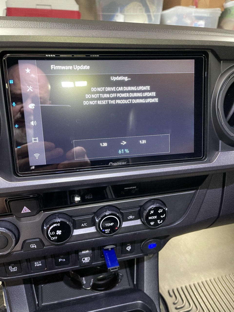

    Updated my FW to 1.31 from 1.3. No noticeable changes.

    Upgraded from 1.3 to 1.3.1. Only thing I noticed of significance was that CarAVAssist seem faster and more stable.

    ^^ USB stick is the way to go? I should try that, only trouble is I ditched my USB port for seat heaters... So not fun to do it with the phone but still probably faster than getting around to installing my lsp8.
    TA-5650 likes this.

    i did it with my Iphone. It was fine, no issues. Was really hoping this would solve the Maestro/CarPlay bugs but I don’t notice a difference.

    Yeah, I've done it twice with the phone, it was less than fun both times. Since you don't have to do it enough it's easy to forget a step, particularly having to go into the unit to transfer or whatever. Reminds me of how much fun it was to update bios on a 386 using floppy disks.
