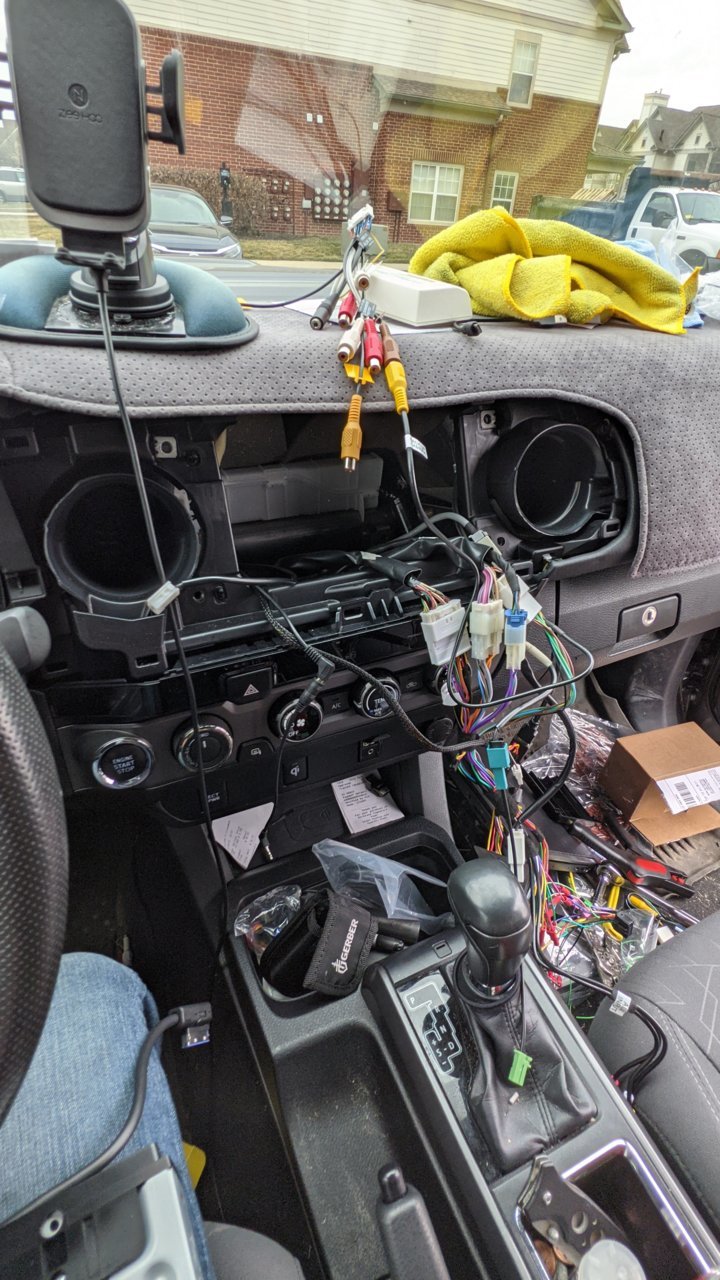

    Install took way longer than I anticipated. Mic photos are here After Market Head Unit - Mic in Factory Location and I'll add what it looks like installed after my cross country. For reference, my friend and I were potatoes and could not figure out the wiring harness because we were looking at the accessory harness instead of the main harness. Full breakdown of it later, here is a photo morning after my drive of shame.

    As long as you have the right harness it is. I recommend opening the maestro harness and the head unit box and wiring the harness indoors. For the pioneer harness, almost all the colors match to the maestro harness. Still have the wiring diagram with the sheet immediately after it for the wires that it tells you to use the manual for. I also used butt connectors (22-18 gauge, the red ones) and a crimper. BTW, a good pair of wire strippers are your best friend.
    Does anybody know why crutchfield put the rca adapter in my recommend accessories?

    You can use it to enable the 3.5mm aux-in via the OEM USB/Aux-in small switch piece. Though with wireless carplay, and the likelihood you have 10 of these lying around somewhere, it's likely not the most important accessory. It's also not expensive.

    I have no clue where to connect it or what to connect it to. I didn't see anything to connect it to on the taco side. Do I have to dig down there to disconnect something? I have to open behind the head unit anyways because I accidentally connected the sat radio to the gps plug.

    Yeah, that's the easiest one to get wrong, sat vs gps.
    The pioneer has aux in which I believe is 3.5mm (black female). The maestro wiring harness from the rr2 has the male rca's. Unless I'm mis-remembering. It's between the maestro harness and the pioneer feeds, you might not have seen it if you haven't connected the pioneer pigtail with all the rca's.
    Dazed[QUOTED] likes this.

    I'll look again when I pull the head unit to do the gps, but I don't remember there being any on the main harness itself. I feel like I should have documented the whole installation process and uploaded it to youtube, since I couldn't find one that applied to a tacoma. Might do that once I get to the end of this coast to coast. Just spent two days snowed in because Wyoming.

    If it makes you feel any better about it, I missed it myself, asked for help, then saw how obvious it was after receiving the info I tried to pass on above. It's not super important, I've never used the 3.5mm jack and I don't see any reason why I ever would, but it's all there, just easy to miss.
