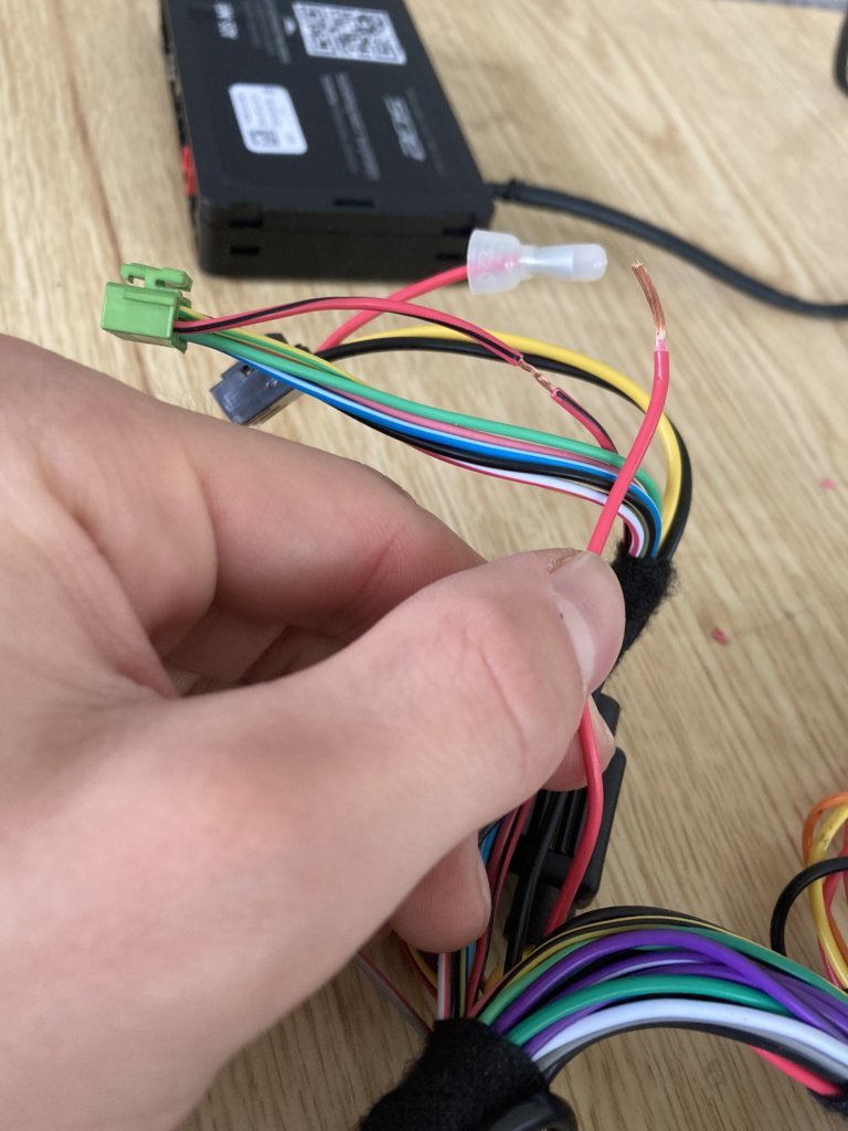

    I found this on AVIC411 to bypass the Maestro power. I’ll give it a shot and report back. I’ll also flash the maestro to disable the TSS / BSM since the old bumper is gone.
    “Made a jumper from the black/red wire to the red wire from the radio and capped the end going Into the RR per Maestro support. This will isolate the issue if it’s actually maestro related or radio related. Pretty sure the power goes directly to the radio now and not though the maestro. We’ll see if this fixes it.”
    This workaround solved that guys problem.

    Yup, that is my post per instructions from idatalink support! Glad you found it! Always takes me a bit to find it.

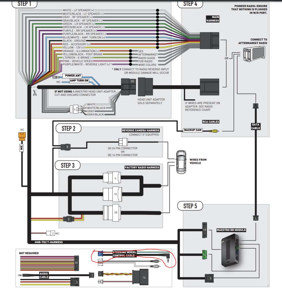

    Hello, I've installed my setup as shown in the diagram.
    It says that the steering wheel control cable is not required.
    Either way, I have tried with and without it and I still am not able to get the steering wheel control working. Additionally, my reverse cam does not trigger full screen when shifting to reverse. I have purple/white connected to purple/white.
    Has anyone experienced something similar? Or is it something I am doing wrong? I have both firmware updated.
    EDIT:
    Thanks to
    NIU_Huskies
    I have found that there is an additional harness to be connected coming from the truck. This makes a total of 4 factory radio harnesses which are not reflected in the diagram. There is only 3(step 3)
