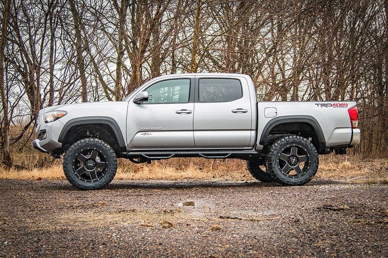

    So I was interwebbing and I found out Rough Country has come out with a 4" lift kit. It appears to be a spacer lift on steroids... Can someone who knows what they are looking at give a proper opinion to those of us that are less educated. If it's worth a shit I may spend the grand on it...

    It's a drop bracket lift like their 6". Requires cutting that is practically irreversible. It wouldn't be easy to go from this to a icon extended travel kit. The general consensus is these kinds of lifts are more for show than performance.

    Yeah the more I read the more I see that it's an awful idea for where I'm going with my truck. Especially that it says it won't work on stock wheel size... And only increases the clearance for a 32x10.5 tire
