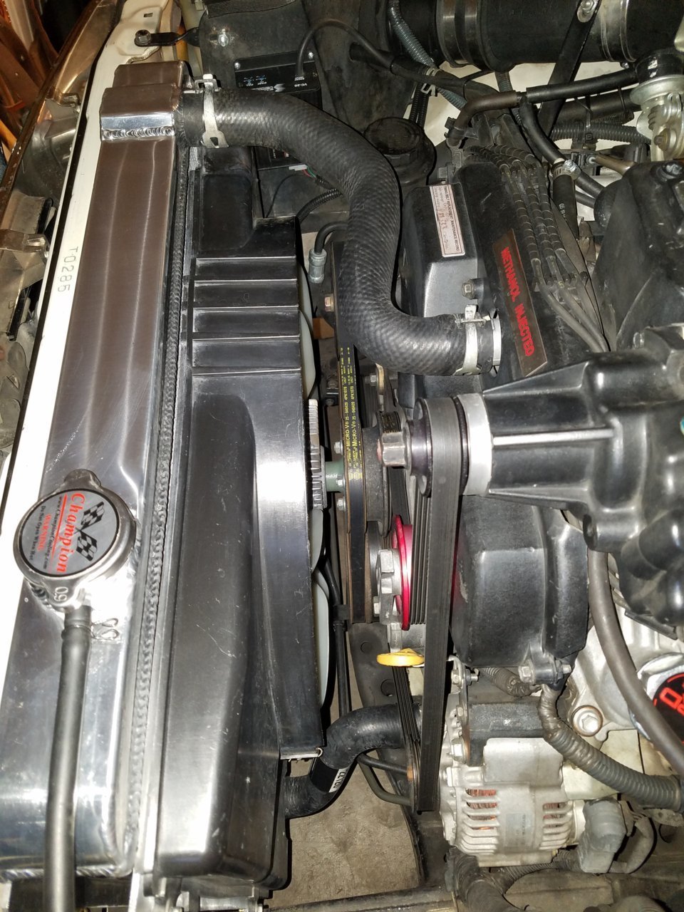

    Hey my radiator's plastic cracked and I have it off and am looking for a replacement. I can't find any decent quality ones that specifically fit my truck (a '00 3.4L Manual). I know I can throw in the auto tranmission one but seems like I'll lose some cooling real estate to the a/t coolant section. I'm also seriously considering going all aluminum (so nothing cracks again), but the only one I can find doesn't give any dimensions and I'm hesitant to buy one that I'm not sure is 20 3/4" tall.
    Any ideas? Here is the link to the possible one: Liland Global Radiator https://www.rockauto.com/en/moreinfo.php?pk=10331536&cc=1364723&jsn=10889&jsn=10889
    If not I might just go spectra premium CU1774 for auto tranny and it should all be fine.

    You're not going to tell any difference in cooling if you use an AT one with the ATF heat exchanger tube.
    I saw that all aluminum one from Rock Auto but couldn't find any info on it so I passed. Unfortunately Mishimoto doesn't make one. Champion makes one & is what some of the guys here are using but it requires some minor mods.
    I just ended up getting a Denso stock replacement & called it a day. My stock radiator lasted 17 yrs before the top end cracked & even then it didn't cause any overheating. If the Denso I have lasts half of that I'll be more than happy.

    I was in the same boat as you with a 2000 manual. I really wanted to get the champion 3 core aluminum but they're still not out so I went with this: https://www.napaonline.com/en/p/NRS2823 which is the Spectra Branded radiator, the benefit of getting in store is that you can inspect the rad before and really examine the plastic tanks. The spectra was built well and the plastic looked better than the original harrison radiator that was in my truck.

    Pretty squared radiator.

    Problem with this is that its out of stock with no sign of availability.
