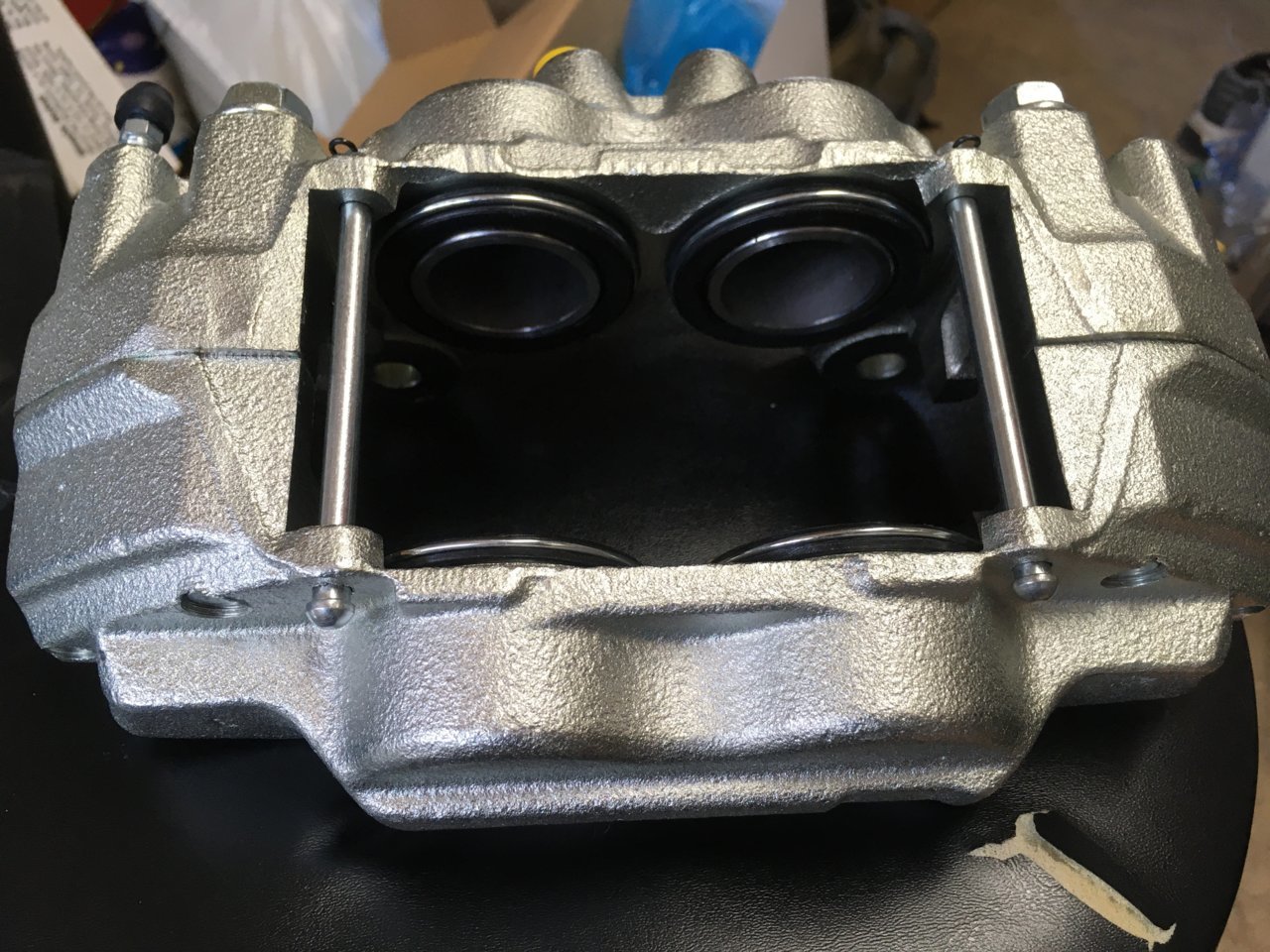

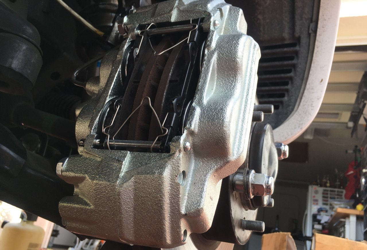

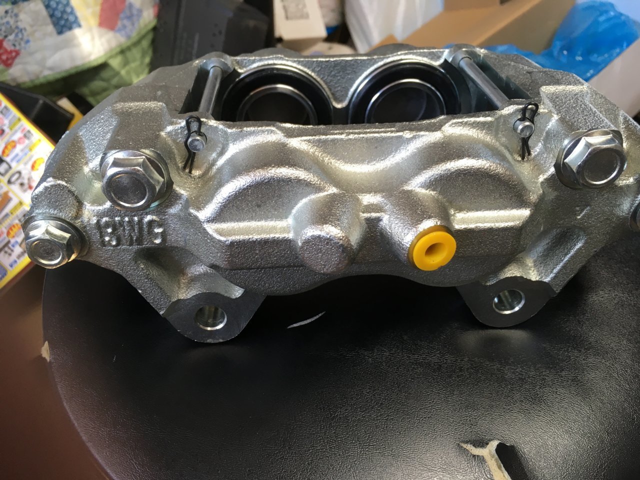

    I finally got tired of the occasional pull to the left when braking and purchased these.
    I rebuilt the stock 14 year old Tacoma calipers at around 11 years old but the left front inner piston must have been out of spec as it finally came back. The inner pad had uneven wear.
    Totally zinc plated new calipers from Rockauto for under $90 delivered. Unfortunately made in China but hopefully to Raybestos specs. No core charge or exchange. They came with new slide pins, cotter pins and pad tension springs .
    I could have bought new pistons and rebuild kits for about $70 a caliper but for $18 more I don't have to. The original pistons were starting to corrode from the inside, yes even in Florida. I bought the right side also after looking at the piston corrosion on the left side.
    No more pull and installed smoothly. Just thought I'd share.
