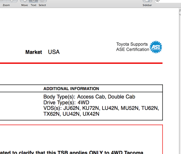

    Hello,
    I have read the rear leaf TSB a couple of times looking for the VIN numbers that this applies to. Others keep mentioning the VIN numbers on page 1. I can't see them listed.
    Can someone point them out?

    Sorry, but I am still not able to see the VDS numbers. I have the snippet from the VIN on my truck. But in the TSB I do not see where they are listed. Everyone keeps saying at the 'top' of the TSB. But I do not see them. Does 'top' mean page 1? I do see on page 6, where they start the alignment procedure it starts breaking that out by VDS. But I am not seeing anything on page 1 or 'the top'.
    Apologies for being so 'tarded about this.
    TIA

    Top of page one to the right.
    If you fall into and of those Vin number groups go to page three and check the part#s on your truck's leafs.Behind the wheel on leaf top.Use a mirror.
    If you have the 3 leaffs now chances are you'll have the old part #s.

    This is just friggin' crazy. I have tried a couple of different pdf reader programs and I still do not see the Vin number groups at the top of page 1. In the 'Applicability' section it lists years, models, and additional info. For the models all it says is Tacoma. Under that is a red 'supersession notice'. Then the introduction and then the parts information. I am looking at T-SB-0305-08.pdf. I downloaded it from one of the links in the threads here.
    Thanks again.

    Here is a snap shot of the right corner of page one
    VDS(s) JU62N and so on hope it helps.

    VDS #s
    JU62N,LU42N,MU52N,TU62N,TX62N,UU42N and UX42N
    If you have these part#s,you have the old leafs
    48210-04550
    48210-04190

    Top right, bottom part of "Additional Information", Line 3 is
    "VDS(s): JU62N, KU72N, LU42N, MU52N, TU62N,​
    TX62N, UU42N, UX42N"- your VIN# probably includes one of these sets of characters. Mine has LU42N as characters 4 though 8 of the VIN #.

    Many Thanks,
    I got a match.
    I wish I could remember where I downloaded the tsb from. It has obviously been edited. Like beeftaco, I used preview to view it and I just double checked and they are not there!
