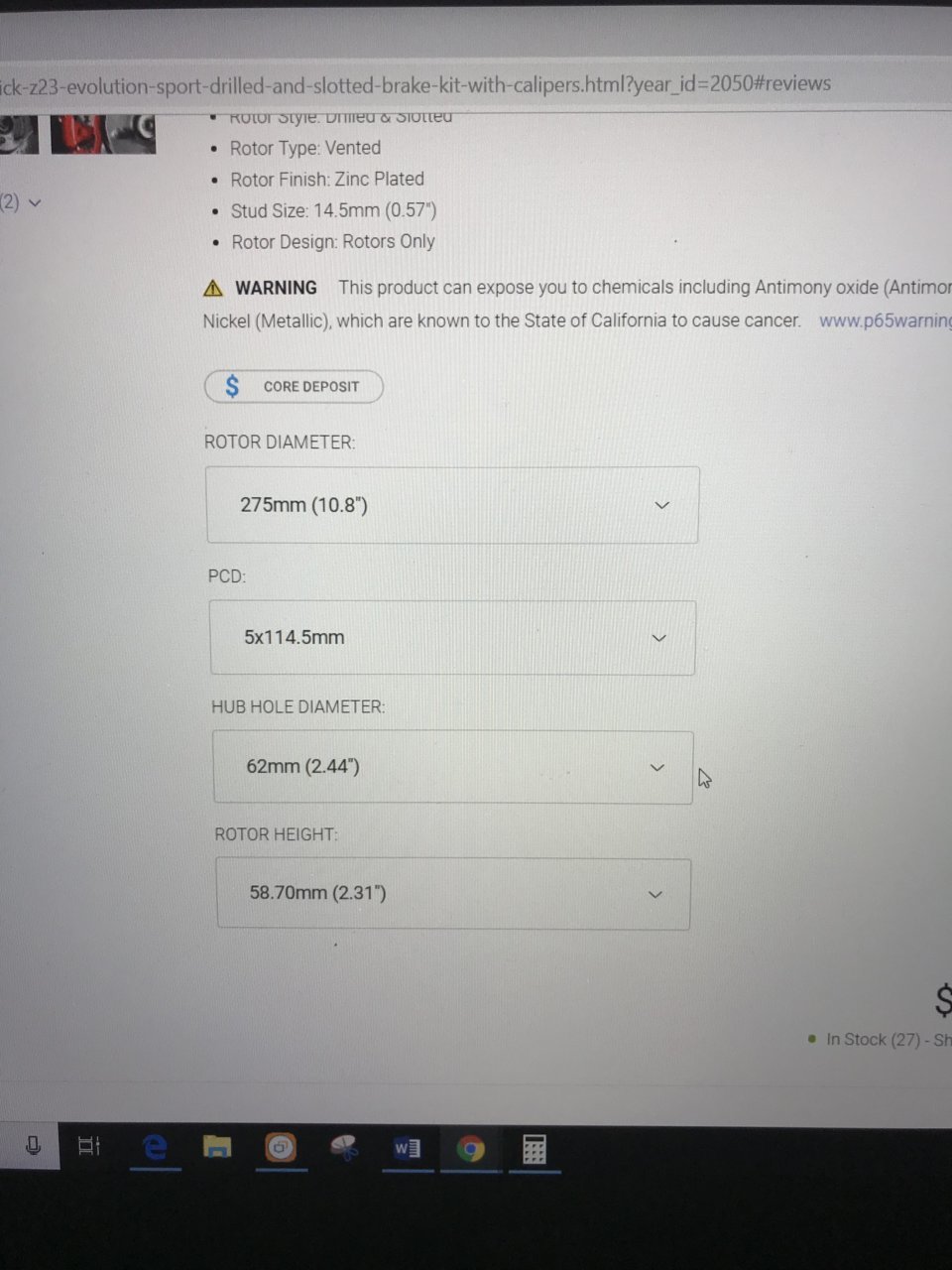

    This is what the client service rep hooked me up with. I have 6 lug nuts. Lemme know if you think that’s correct.

    I just found the same information. It looks like they sold you the wrong one.
    As you can see they sold you a 5 lug rotor Notice the PCD is 5 X 114.5mm.
    You need the 12.6 inch diameter rotor
    Specifications:
    Location Front Axle Rotor
    Centering Diameter 108 = 4.25197 inch
    Disc Thickness 28
    Front/Rear Front
    Height 67.2 = 2.6456693 inch
    Num. of holes 6
    Outter Ø 318.8 = 12.5511 inch
    Pitch Circle Ø 139.7
    Type Vented

    You guys saved me a huge hassle! I called them this morning, and had the item changed out before it shipped! Saved an additional 50 $ for the inconvenience as well. You guys are the best, thanks for having my back!
