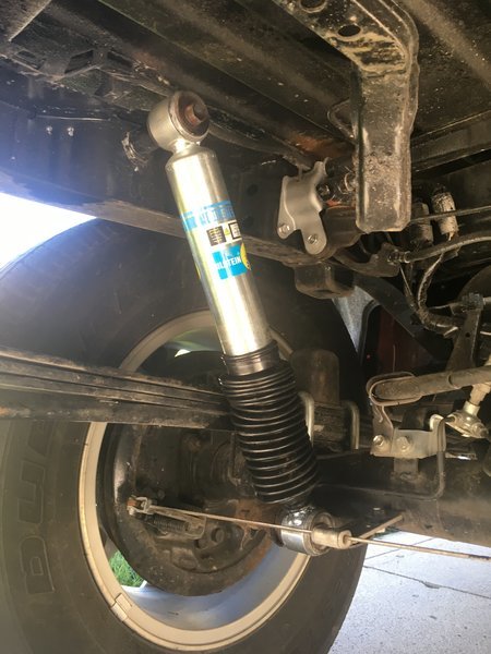

    Got Billstein 5100's on the way from DownSouth motor sports. Got the package deal today around 10:20 and they are showing delivered to my door tomorrow. Can't wait to see em.

    Got the rears put on. Doing fronts w/ 2" level within the next few days.
