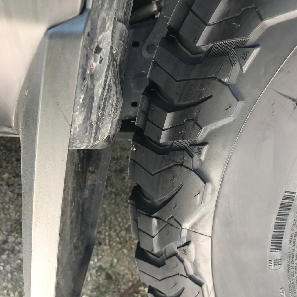

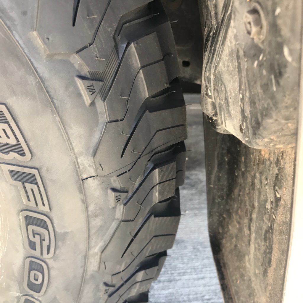

    Got shoes! I decided I didn't want to push it too far and wanted to go for the 255/80R16 but apparently they don't make KO2s in that size. I went for just a small size up from my Offroad stock wheels - up from 265/70R16 to 265/75R16 and I'm glad I did. Tons of room around the rear wheels. No rubbing in front at full turn but check out these photos at *half turn*. That's where you're gonna see rub first on the front wheels! Right by the mud flap area. So with these 31.2" tires I'm seeing only half an inch clearance. I just can't imagine how one wouldn't have rub there with 32" or 33" tires. I don't think I'll be going any larger than 265/75R16 anytime soon...

    Right! I just can't imagine how the 85s wouldn't rub though considering how tight my 75s are (as pictured). I wish they made 255 KO2's in more sizes!

    yeah, probably have to get the heat gun out if you would have gone bigger. I had 255s on my GX and loved them. But that was with an OME heavy setup. I actually have the same tires on my truck as you! IMO they are the best size for a stock suspension TRD OR.

    255/85/16 are confirmed to fit with no rubbing using stock TRD OR wheels
    They do make KO2's in lots of sizes, but it's more that hardly anyone makes tires at 255/85/16 - I can only think of KM2's and ST MAXX
