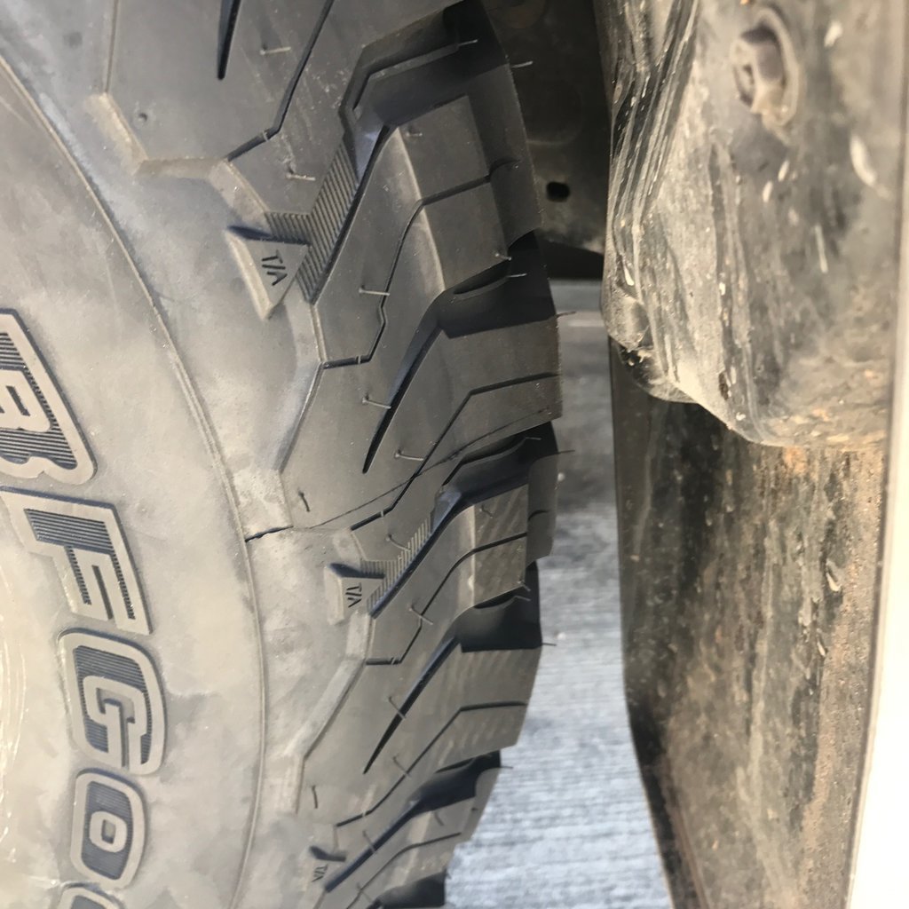

    That's cool forty2, thanks for the link! Can you or STexaslovestaco or anyone else show us photos showing the gap at the rear of the front wheels at half turn on your 33" tires? Like this:

    235/85R16 is considered a 32", but here you go nonetheless:
    Unclear who you're asking. If it's me, here you go:

    Ahh, 235/85 is 32" - I get it! Thanks. Anyone care to post photos of 255/85s at half turn - rear side of front tires?

    Yes, but that thread doesn't have photos of the 255/85R16 at the half turn where they would first rub! No one seems to have those photos! I put 255/85R16 on my OR on my OR wheels and they rubbed! Had to go with 265/75R16. I'm curious to hear why so many are saying they aren't having rubbing but simultaneously aren't showing photos of this half turn. I suspect they don't realize they're rubbing or they've modified this critical first rub location... or my 2016OR is different somehow...
    Like I showed photos of - yes - KO2s. And yes I did my homework! And yes I asked for more clarification. My research shows that 255/85R16 on an OR shows rubbing at the half turn which is counter to what others have said - thus my request to see photos and research a little further...
    Update - maybe it's the mudflaps! I thought they were only adding 1/8" but maybe there's more there than I realize.
    Thanks for the dialog y'all! Very helpful.

    The first post has the wheels turned in one of those pictures. I think the difference is you've got the mudflaps and OP of that other thread doesn't. Plus extra armor maybe. I dunno! Just trying to help, don't have any direct experience (waiting on my stock tires to wear out)
