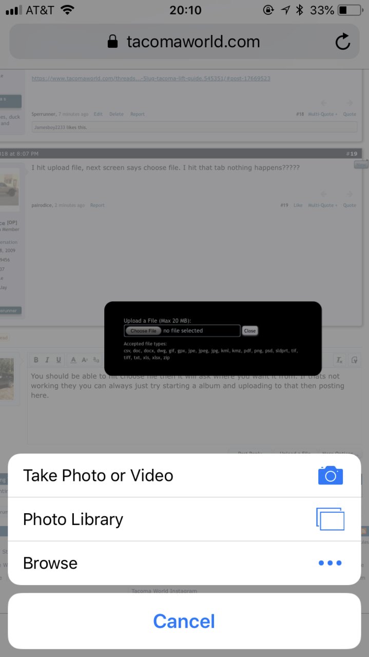

    I hit upload file, next screen says choose file. I hit that tab nothing happens?????

    You should be able to hit choose file then it will ask where you want it from. If thats not working they you can always just try starting a album and uploading to that then posting here.

    I never get the white tabs on the bottom of the screen. I tried albums with same result. I even tried changing to desktop view. It's a galaxy s7 if it matters. I am definitely not great with computer stuff anyway
