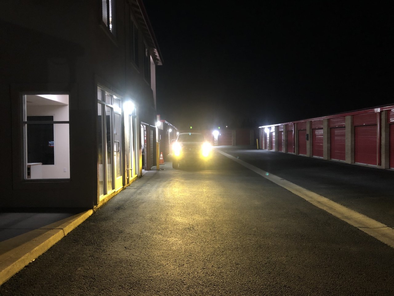

    Just installed my SS3 pros fogs in yellow. What a massive difference over the stock fogs, like no comparison at all. I have them pointed down all the way and they almost seem too high. Good part is I’ll mostly use them on trails and in high dust areas. Anyone else install them and get flashed from other drivers?

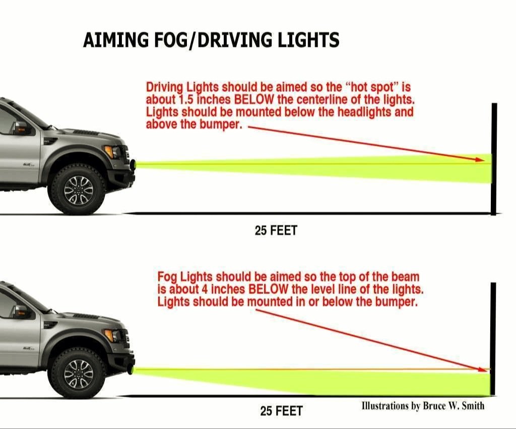

    Getting flashed by other drivers isnt a good standard to measure things by. Using actual measurements is a better way. If you set them properly then you will be using the fixture to it fullest potential without hurting/distracting other drivers. After properly setting them and you get flashed, then they are complaining for no reason or they really like your truck. :D
    Since these are so powerful, proper focus is essential. I have the sports and they are crazy.

    I made sure the cut off line of my fogs were below the cutoff line of the low beams. They are bright, but with this aim they should be street legal.

    That makes sense haha. I set them as low as possible and my truck rake is close to factory with my lift. What it seems like now is they are just so bright it’s hard to see the cut off line but its for sure not as high as the low beams. They are higher than the factory halogen fogs and the picture doesn’t do it justice. Either way I’m happy with them. Plus I only use the fogs when necessary.

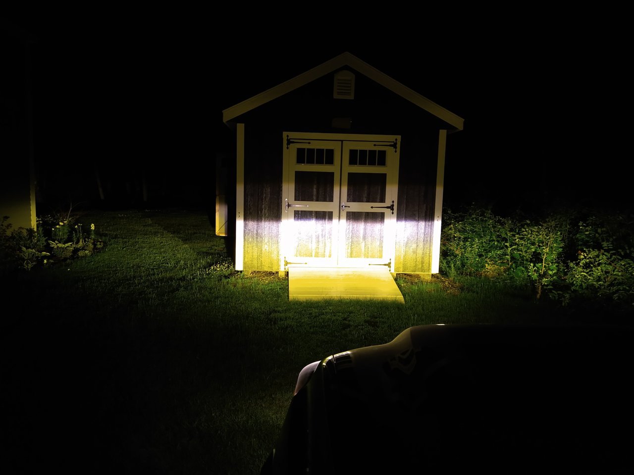

    This picture is with my low beams and SS3 fogs. Truck is about 30 feet from shed. You can clearly see the low beam cut off, and sort of see the fog cut off below.

    That’s a really nice cut off. I think the wall I was using might have been lite up too well from street lights or just too lite of a color. I’ll try something else to line mine up.

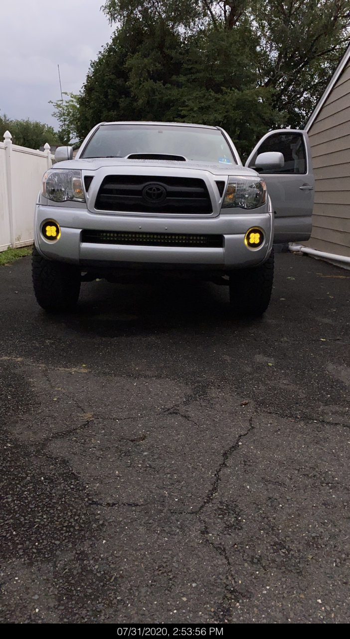

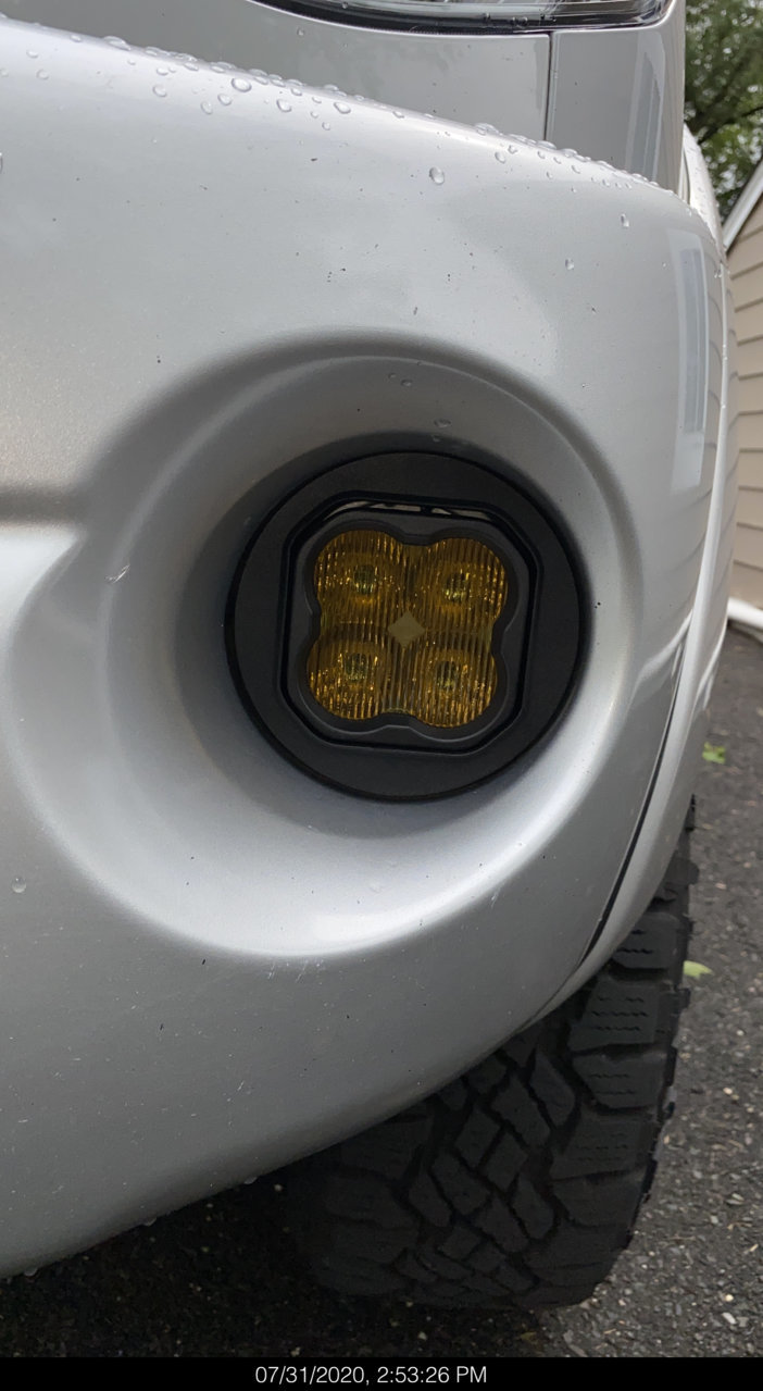

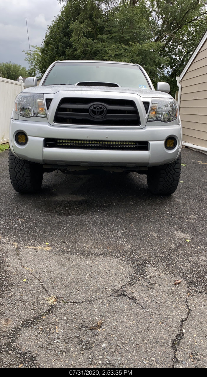

    Got my ss3 installed today took about 15 minutes. The housing is so much more nicer than the baja ones i had . Haven’t tried them out at night yet. And i feel better that there street legal BFB6A308-6111-4541-9F7E-B348B9095301.jpg7903710F-8EA8-455B-BE3A-258C05AE4F5F.jpg 7643E5AD-00E7-498D-B684-3B2697D7B8E2.jpg
