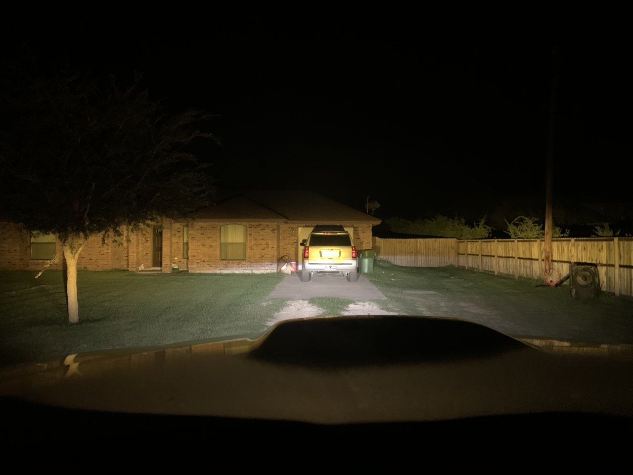

    The OEM adjustment screw gets swapped over to the SS3 pods and placed in the bolt hardware mount they give you for that screw.
    See my install write up on my 2010.
    F1.5 ISO 800 on a dark state road.After focusing them more precisely.

    Your added hints on adjusting these type fogs should be helpful to others, yours seem well adjusted. Answered my questions as well, thanks!

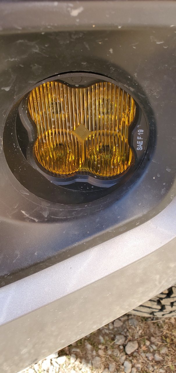

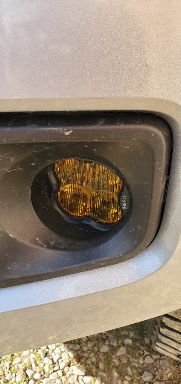

    One screw mounts to the rentention slots, the pods should be oriented as far down and then they can be angled downward a bit more.
