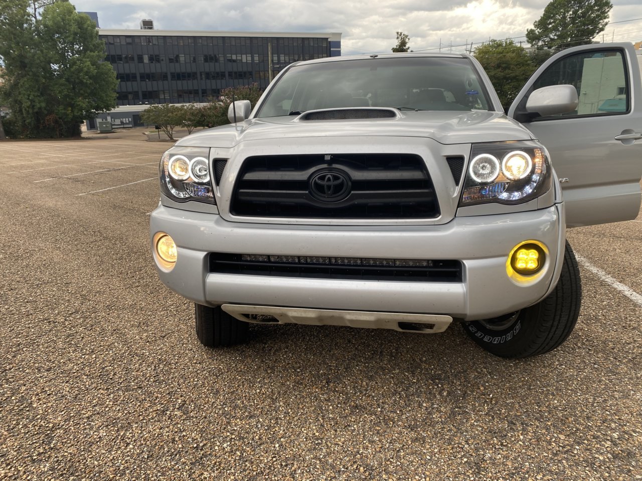

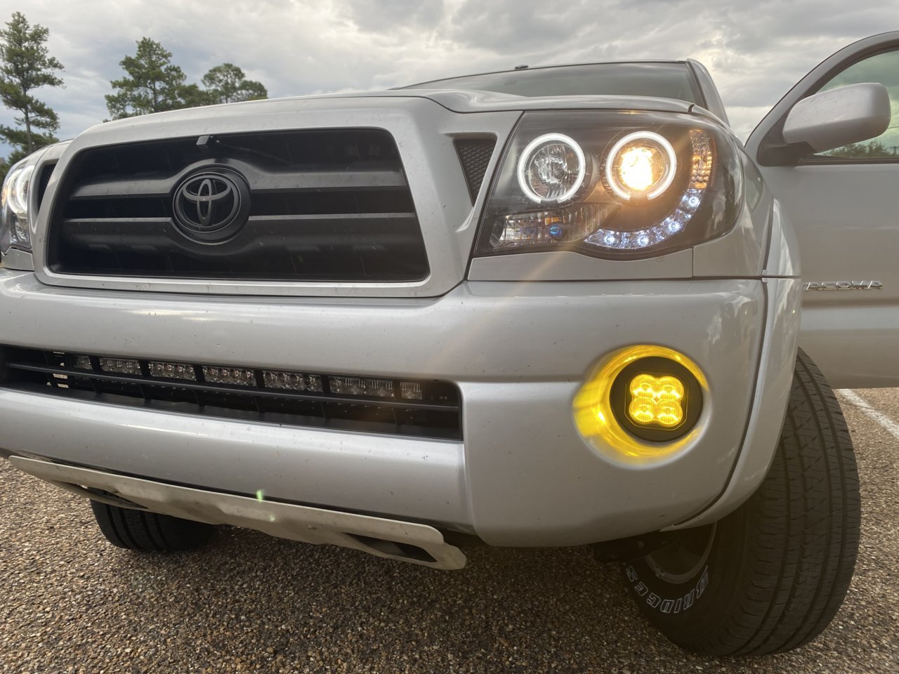

    Man! One thing is for sure about this SS3 fog light mod! It’s not a simple easy peasy deal. My WORD. Did any of y’all have issues with the bolt falling/slipping out when u were trying to tighten the Allen on? I swear I must have tried legit 8 times before I finally got it. The middle bolt on the drivers side. A combination of trying to do one at a time to trying to do both simultaneously. To doing one at a time again. dam it was frustrating. I only had time to do one bc I’m on call and also It was about to downpour and i had spent 2 hours outside ! Also. Does yalls have like some give to it Not flopping around, but it’s not like set in stone. I can press on it and it moves a bit. Maybe I have to tighten down more. But I had to get inside with rain coming. Man I don’t know how easy these are to adjust but if it’s as difficult as it wasgoing in I may just have to call it good as is

    Attachment bolts. Any mild tilting will throw the nuts out of place. Mine rolled out backwards and fell into the light assembly or mounting recess or simply on the ground . I remedied it by plugging that “escape route” with Tessa tape and kinda bunched it there too so it could act as a place holder. I was then able to tighten them down nicely. Man just that one little pearl would have saved me an hour and a half at least on doing the other side. Man it was a biatch!

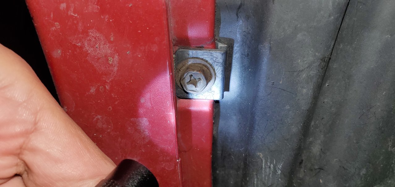

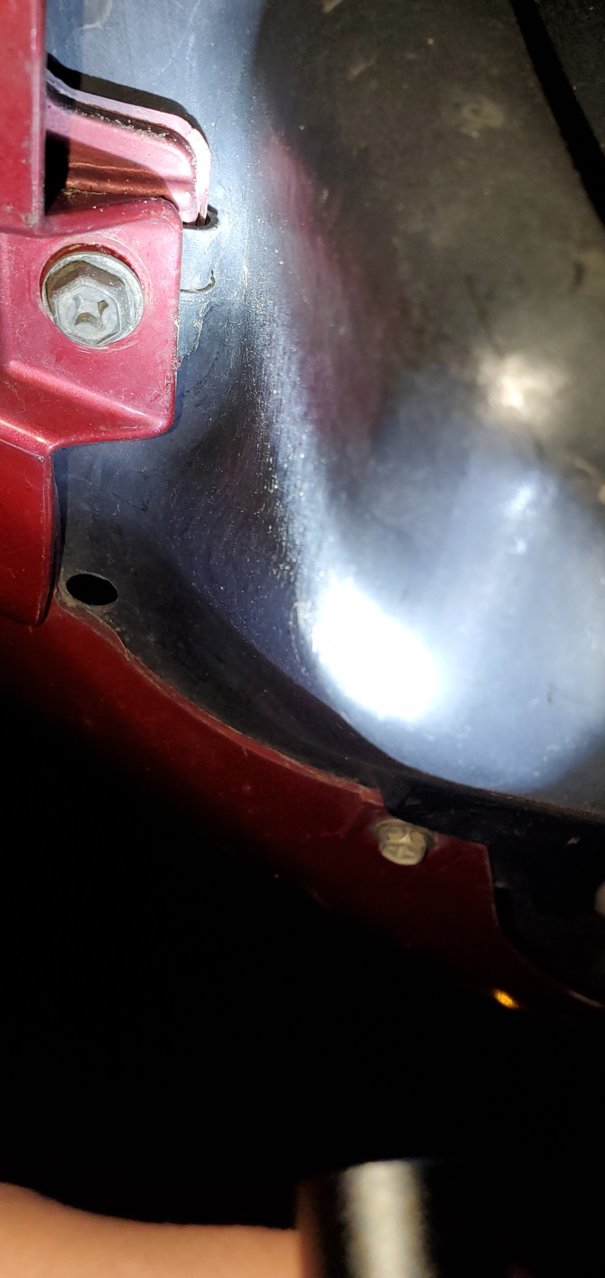

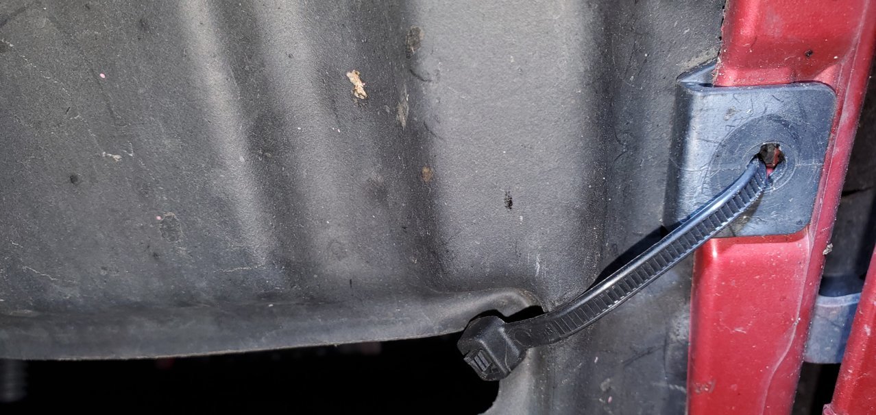

    @tattooedsnake man I had some issues getting my fender liner thing installed back correctly and all together. Any tips u know of or like a pictorial of the way it all comes together ? I removed The things they said but for some reason this passenger side I did isn’t coming together as nicely as the driver side did.

    @prone2xl I took some pics of mine. I had an issue getting the black tab reinstalled before. It needs to sit in between the body panel and the fender liner itself. That will "clip" them together and give you a place to thread the bolt to.
    I lost one of the bolts so I used a zip tie for that one lol.

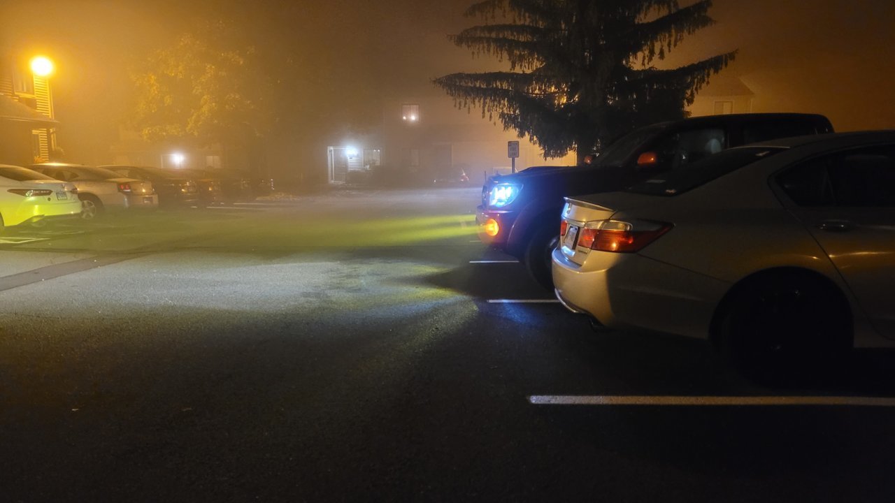

    I dont have the Driving pro's but I have the Yellow fogs. I finally got some heavy nighttime fog the other day and was able to finally enjoy them for the intended use. The yellow does a great job at cutting through the heavy fog and the wide beam is great.
