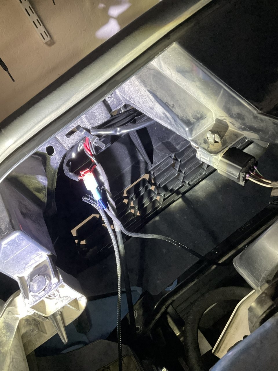

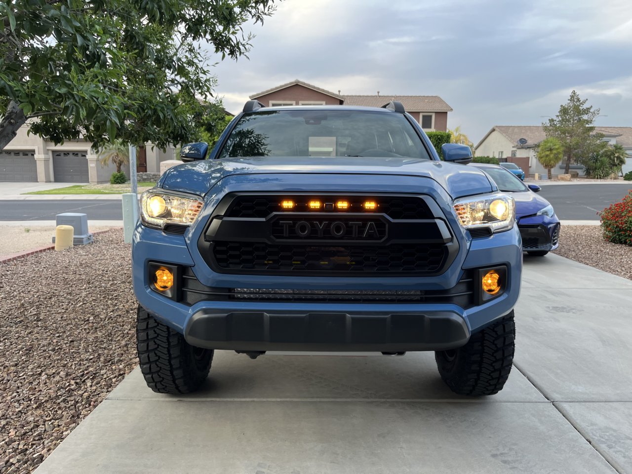

    I installed the SS3’s white fog/driving lights this past weekend and like many others I struggled with where to tap in for the backlight. Then installed the raptor lights when it finally dawned on me “just tap into the raptor lights since I have those coming on with the ignition” and bingo…..upload_2022-4-27_4-44-8.jpg

    Absolutely beautiful Tacoma and killer shot showcasing our backlight feature.
    Thank you for sharing, Kevin!

    I have a couple of questions about the wiring for the backlight on the SS3 LED Fog - Pro. I currently have "raptor" lights connected via an "Add-a-fuse" into the ignition fuse on my 2018 Tacoma Limited. The "raptor" lights come on as soon as I turn the truck on and stay on. I am wondering if I can t-tap into the "raptor" lights wire and if I can put 2 t-taps on that wire (one for the right fog and one for the left fog)? Any advice would be much appreciated.

    Short answer is Yes! That is exactly how I worked the backlights. To make it even easier I put both backlight wires into the same spade connector to put into one T-tap on the red raptor light wire. That way I only had one tap.

    Yes, this is a very popular route. You can t-tap to your Raptor lights as MystiqueTaco has performed above. This is because the power draw is very low for our backlight feature.

    Did you cut off each of the red connectors on the backlight wires and then crimp both of them into one connector and then connect that into the t-tap?
