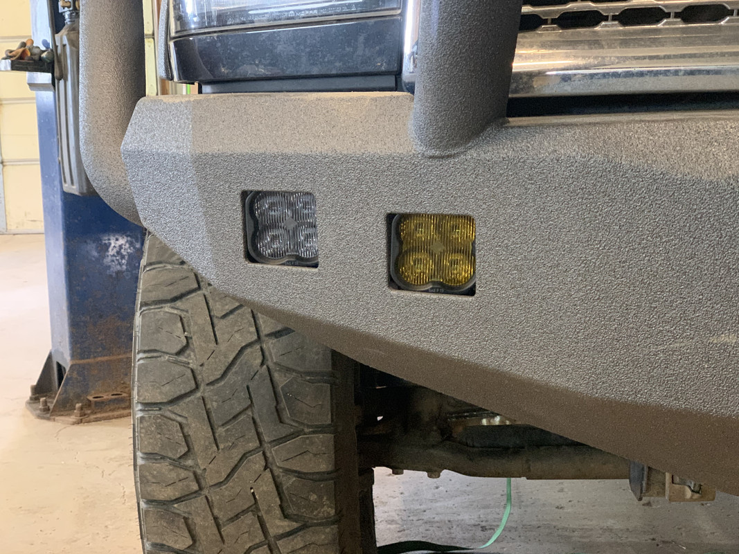

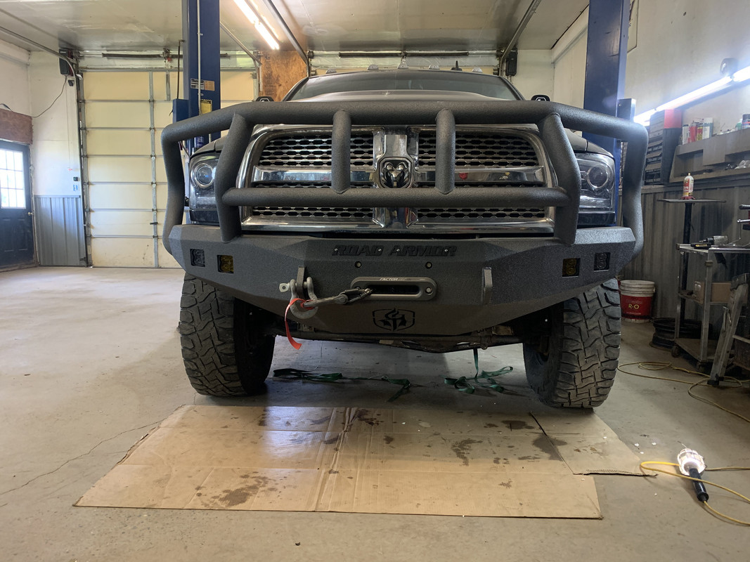

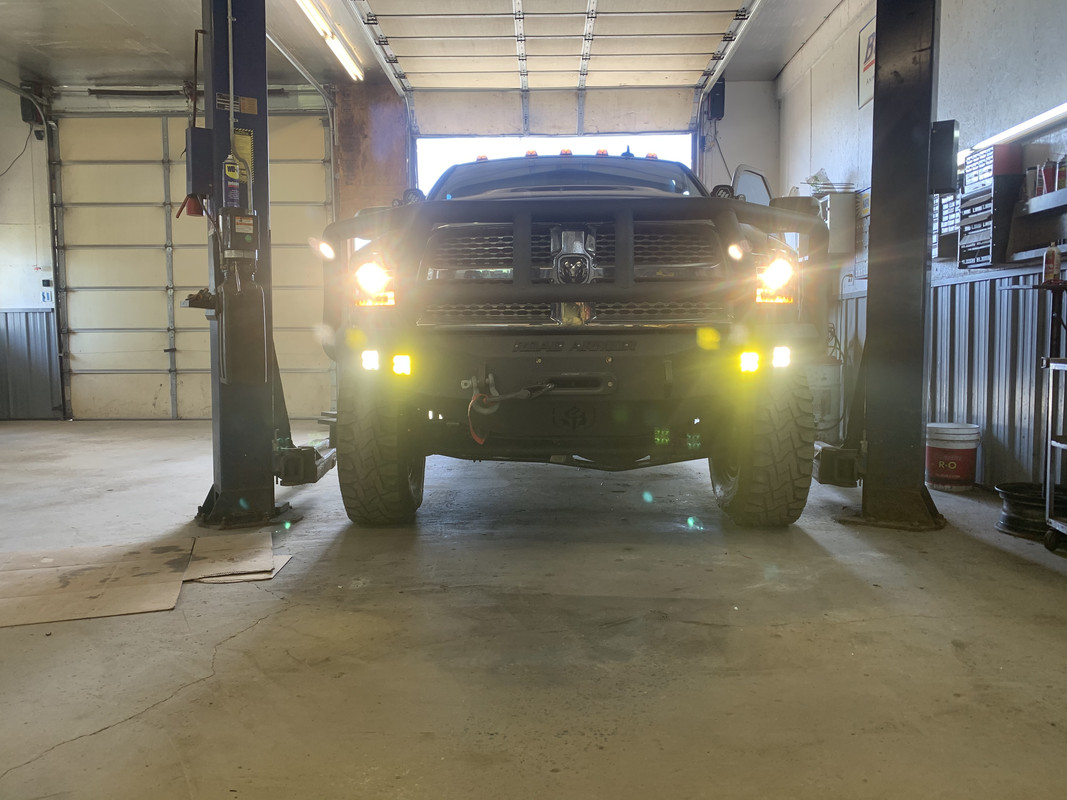

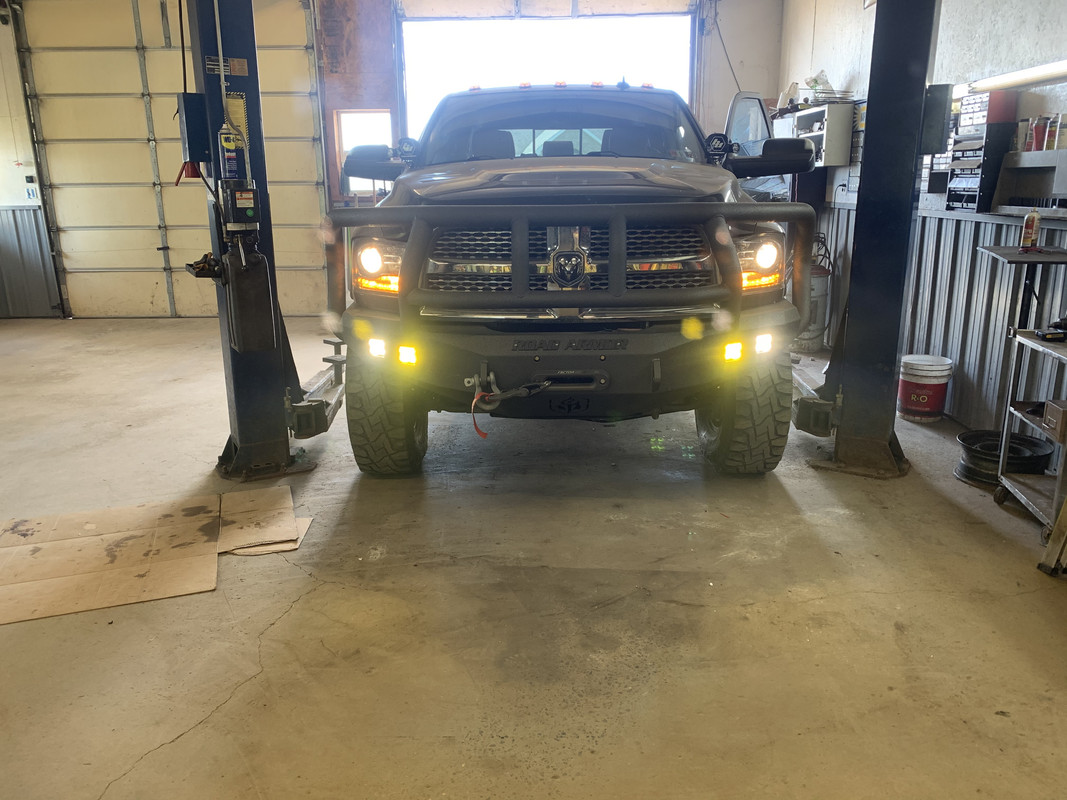

    Got both sets of pros installed in my road armor bumper. 2 selective yellow and 2 selective yellow with clear lenses for the 4k color output.

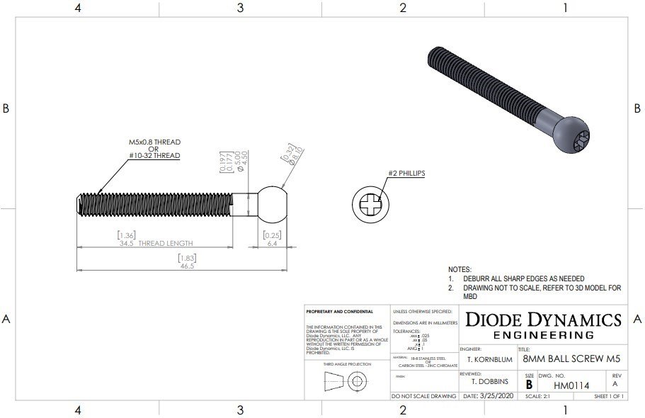

    The provided "bolts" that are used on each side of the assembly are screws and will require a 4mm Allen key. I found that using a 90* allen key in order to access the side screws made it easier. The screw that is on the outside (closest to fender) definitely requires a right angle allen key otherwise you can not access it. The inner screw (closer to engine) can be a little more difficult to get lined up and installed since you can't see it at all.
    I set the adjustment screw to the suggested depth "even with the back of the bracket", but I feel that this might limit the amount of downward adjustment to much right from the start. Maybe try only threading the screw halfway. However, I have not tried using the adjustment screw for focusing yet, I only have used the tension of the side screws. I included pictures of my current focus which has the pods at the bottom of the tension limits with the adjustment screw set at the suggested threading. I have not had much road time with them installed other than driving to the park for initial focusing and photos. I will try using the adjustment screw when I get a chance to.
    Focusing the fogs after installation was not to hard at all. Before finishing with each side. I tightened the outside screw (closest to fender) as tight as I could get it with the nylon nut before I reinstalled the fender liner while leaving the other screw tight enough. When sitting next to the wheel and you have the wheel turned all the way to one side, just like installation, you are able to reach in and access the inner screw (closest to the engine) (The 90* allen key is also handy for this). This give you a clear view to see the cutoff of your headlights and properly focus the fogs below that line and then lock it down with tension of the side screws. I will try using the adjustment screw when I get a chance to, but I think you most likely will have to lay under the truck. So using the side screws for finalizing your focus will definitely make it easier for you to identify where the beam should be. Gotta find that sweet spot with the adjustment screw and side tension, especially if you have a lift and will need to focus the fogs even lower than normal.
