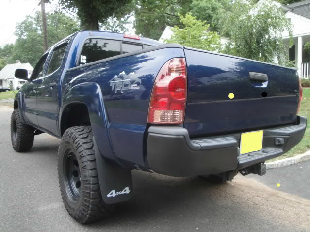

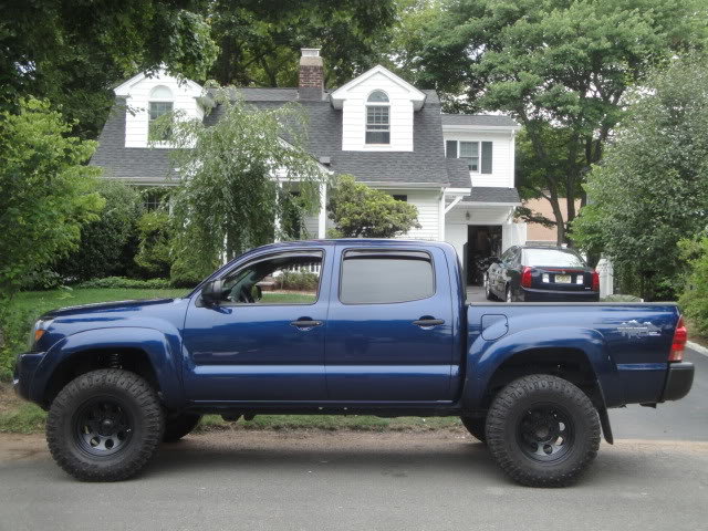

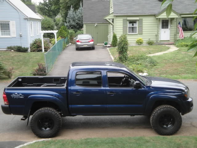

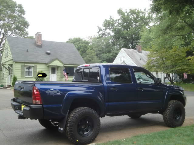

    After hoarding this stuff in the basement for what seems like forever, I finally got around to installing it.
    5100s, eibach springs, 1/2" spacer up front and 5100s, 1.5" aal w/ tsb rear. Couple it w/ the new MT Classic IIs and Duratracs for a complete look. Also ditched the sway bar.
    Final Result....

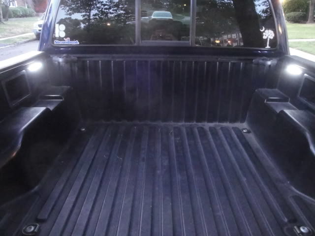

    Oh yea, put these lights in too. Cost me 9 bux and adds a bit of light. Nothing great, but better than nothing!

    Thanks guys! Ojake.... Wheels are 4.437 backspace, 0 offset. Tires are 285/75/16. No wheel spacers.. Only top plate spacers for that extra 1/2 of lift.

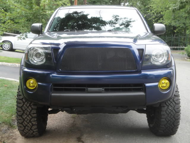

    what is that in the middle of your lower grill?

    EZ Pass :cool:
