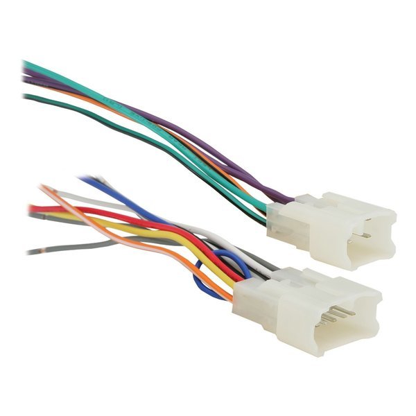

    Sorry for the delayed response, I'm finally got time to work on it again today. I ordered a Metra wire harness to take out my old one for the stock sub, and it doesn't have the right connector.. What wire harness do I need first of all? Get that sorted out then I can try to answer some of your all questions.

    Ya thats why I bought this regular wire harness . I guess I didn't look close enough at the connetor, so I guess I gotta find the right one

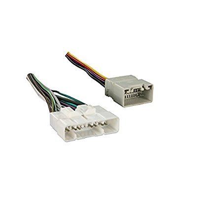

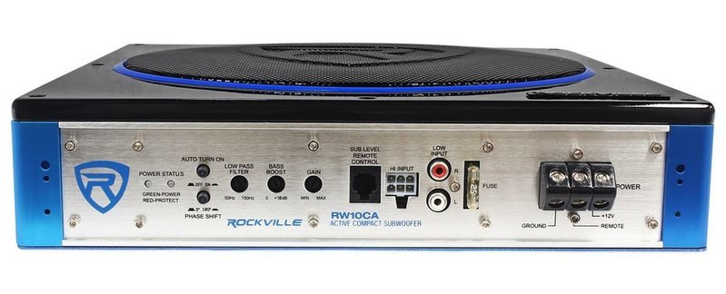

    Can someone tell me exactly how the new sub/amp should be wired from the HU? I think I'm getting myself mixed up. I am currently running the RCA cable and the turn on cable from the HU to the sub/amp. To run the speakers I thought I needed that wire harness.
    Heres a pic of the sub I'm using

    Ok so your power (+12v) comes from the battery and should be fused no more than a 12 to 18 inches from the battery.
    The ground cable should not be longer than 18 inches, use on one of your factory bolts.
    Run the RCA and remote wire together from behind the head unit, if you run them with the power there is a chance of engine noise.
    Those are the only connections needed to hook this up correctly. Nothing should be hooked up to any of your factory wiring.
    With the auto turn on in the off position the remote wire will turn the amp on and with it in the "on" position the amp will turn on when it receives a signal through the rca cable. I don't think it would hurt to have the remote wire hooked up even if you're not using it.

    06 double cab taco
    Ok thanks. And then for the speakers I just need the jbl bypass wire harness right to run out the HU? Here's the harness I bought, should be here Wednesday 31csKy9qorL._SY400_.jpg
