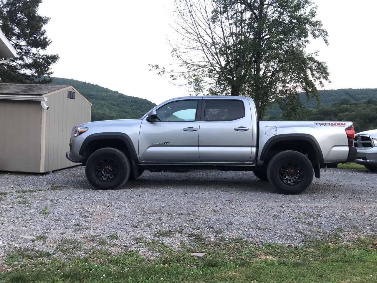

    Went with the bilstein 5100s all around set on the third notch (1.1") up front, leveled the truck perfectly for me too.

    I've been begging 88rotors to do a 17x9 -12 setup and yours is the first I've seen them do. With everything added on what's your mpg look like? Still stock ride quality? Anything you would change? Did you add UCAs??
