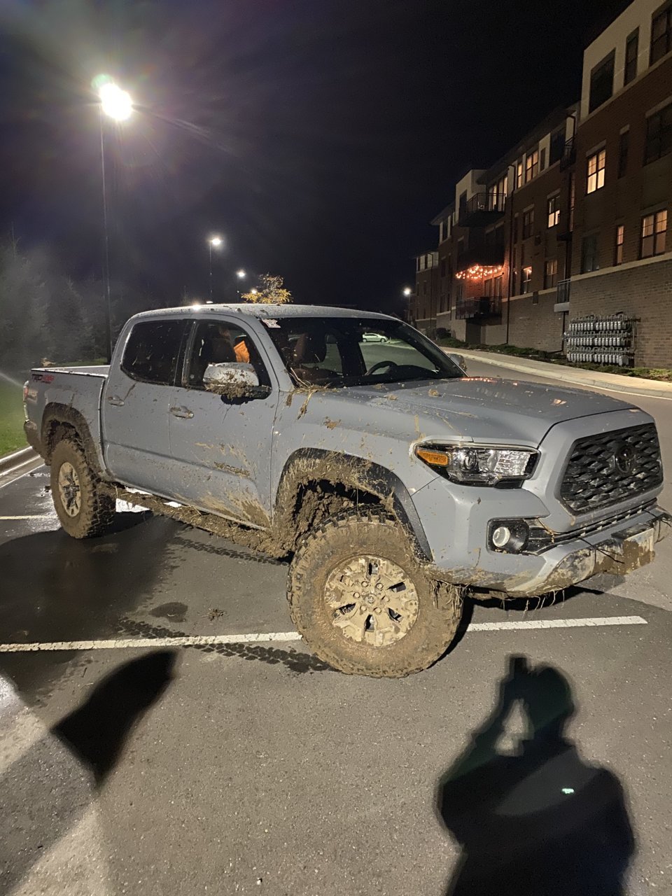

    Like I said, there are tons of posts saying that 255/85r16 fits on a stock taco with little or no fitment issues, including mine.
    Mud Found at the Mall:
