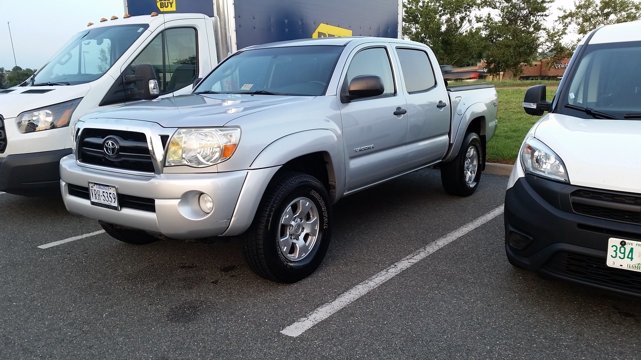

    My truck the day I bought it, stock height 265/70/16

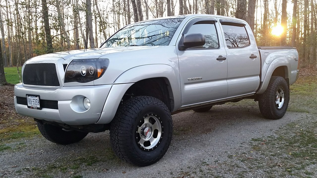

    Lifted 2.5", 265/75/16

    I bet when you put that ding in the left front, near the fog light you cried. Your truck looks great, well done on the build.

    Lol, that shit was already there. The previous owner took great care mechanically but he was the worst driver ever. All 4 corners have some sort of damage.
