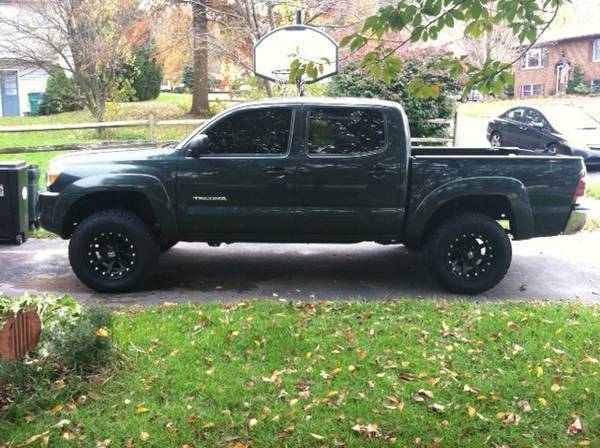

    My truck with 5100s on all 4 corners, fronts set at 1.75", no TSB or AAL in the rear, and 265/65/17 General Grabber AT2s on XD Addicts. I had a tiny bit of fender rub when turning in reverse, but I just grabbed a hack saw and trimmed off the plastic piece at the front of the wheel wells.

    Thanks for the pick, yeah I was rubbing a ton on the fenders, trimmed them back, still needs more though. Big concern on the rubbing on the frame which is why I picked up the 5100s for the front.
