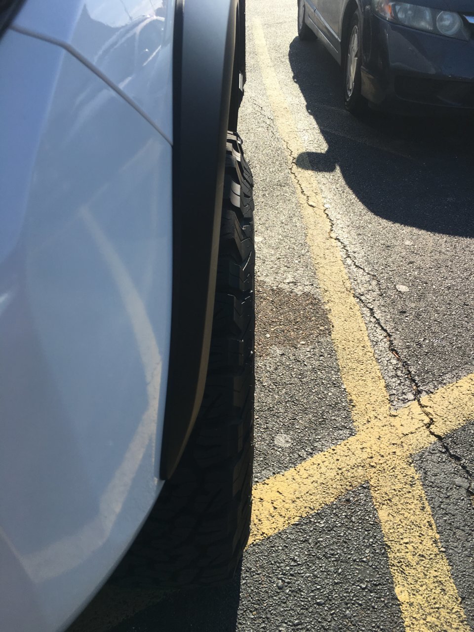

    I have ray10’s which are -10 and I stick out an inch. I think your going to stick out much further.

    I’m running 265/70/17. Might be more than an inch.
