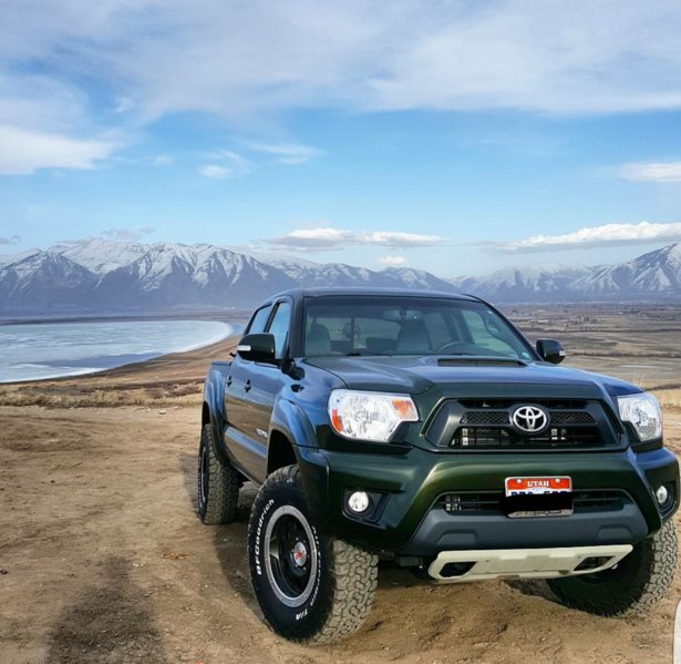

    I really like the BF Goodrich KO2s, size 265/75/16 for stock, looks beefy and doesn't rub.
    (Picture has bilstein 5100s at .85, but I had the same size tires before that and didn't have any problems)

    Mine also came stock with 245s.
    265-75-16 will fit without modifications.
    I was worried it wouldn't fit. Even tire shops around here didn't think it'd fit.
    Tacomaworld.com was right :thumbsup:
