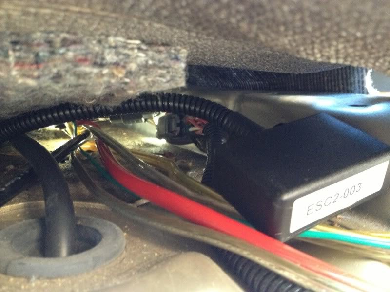

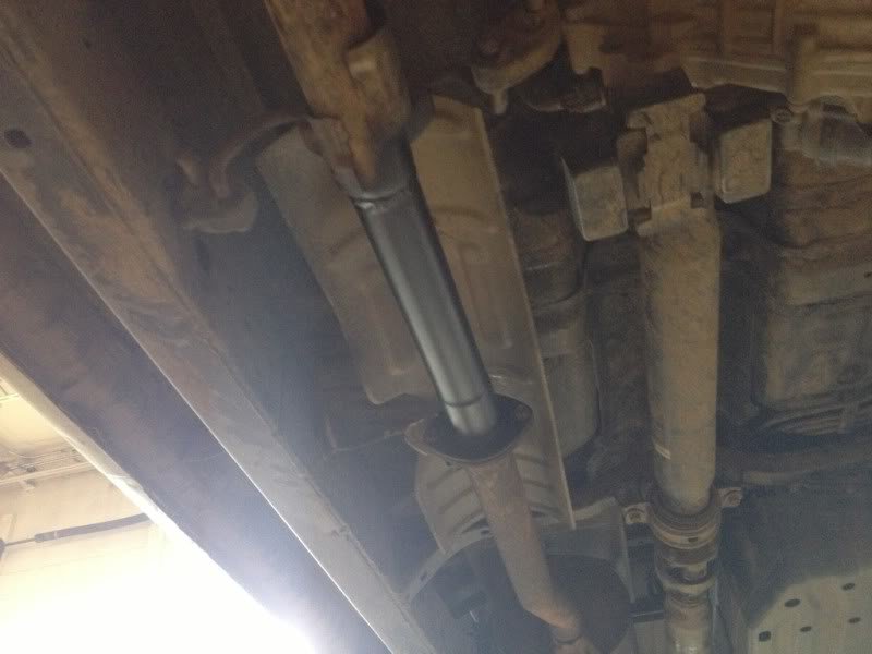

    Yes URD is the brand. it plugs in the harness connected to the O2 sensor (under passenger seat). Theyre are 2 cat converters, and i simply cut the rear one off and replaced with a straight piece of pipe. Since i removed it, it basically fools the computer into thinking that it is still in place, so no check engine light.
    http://www.urdusa.com/product_info.php?products_id=1230100014
    simulator under passenger seat:
    AE115623-BBF4-4CCE-9227-394C588D75FD-859_de603753c0af223d87b02a4b345a0a2883beb6e9.jpg
    replaced with straight pipe:
    EDA76BC7-EE6A-4592-A329-ED69EEA0DCB2-859_fad8584f0109fe21a98b688779917325e61fa958.jpg

    Cool, I understand, mostly. So when you removed the rear cat the O2 sensor came out too? And the simulator simulates the singnal from the sensor...? I doubt I will be able to do the removing of the cat myself as I don't have a shop or the tools. What did it entail?
    If I did that, what do you think would be the impact on a future decision to replace the entire exhaust?

    O2 sensor stays in place. the simulator is just a relay that plugs in the harness under the seat to fool the computer. shouldnt effect any future exhaust u might add
    to remove cat: 1. cut cat out 2. replace with pipe (2 1/4" i believe). thats it
