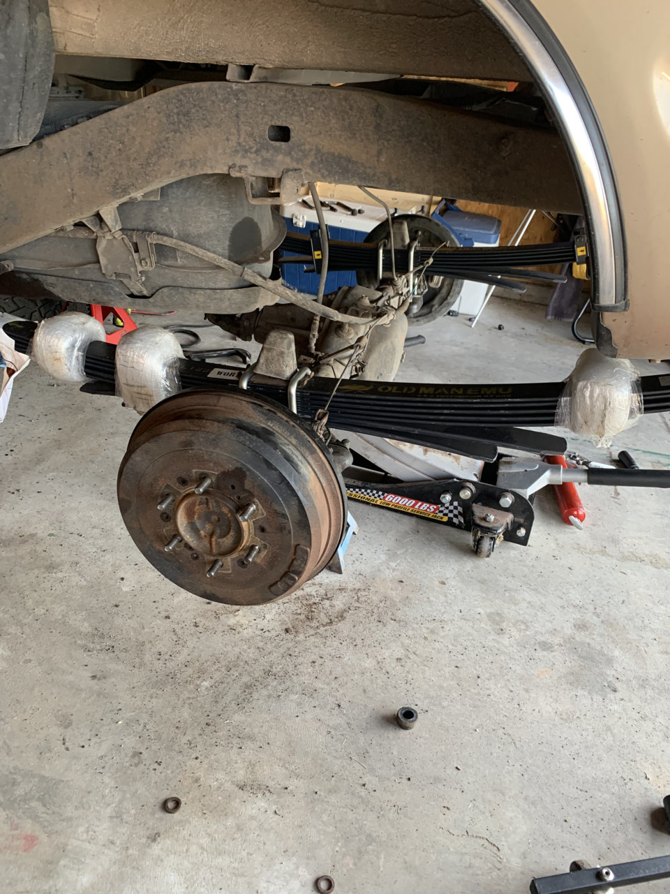

    Thanks guys. Just got one leaf pack out. Had to cut the front bolt and use a BFH on the rear shackle. Busted my hand so I’m done for tonight. I’ll go after the second leaf tomorrow after work. Would you guys recommend installing the first leaf pack before I remove the other? Right now I have the driver side completely out but the passenger is still all bolted in. Can’t decide which way to go. My thought is doing one at a time might keep the axle from moving too much. Thanks.

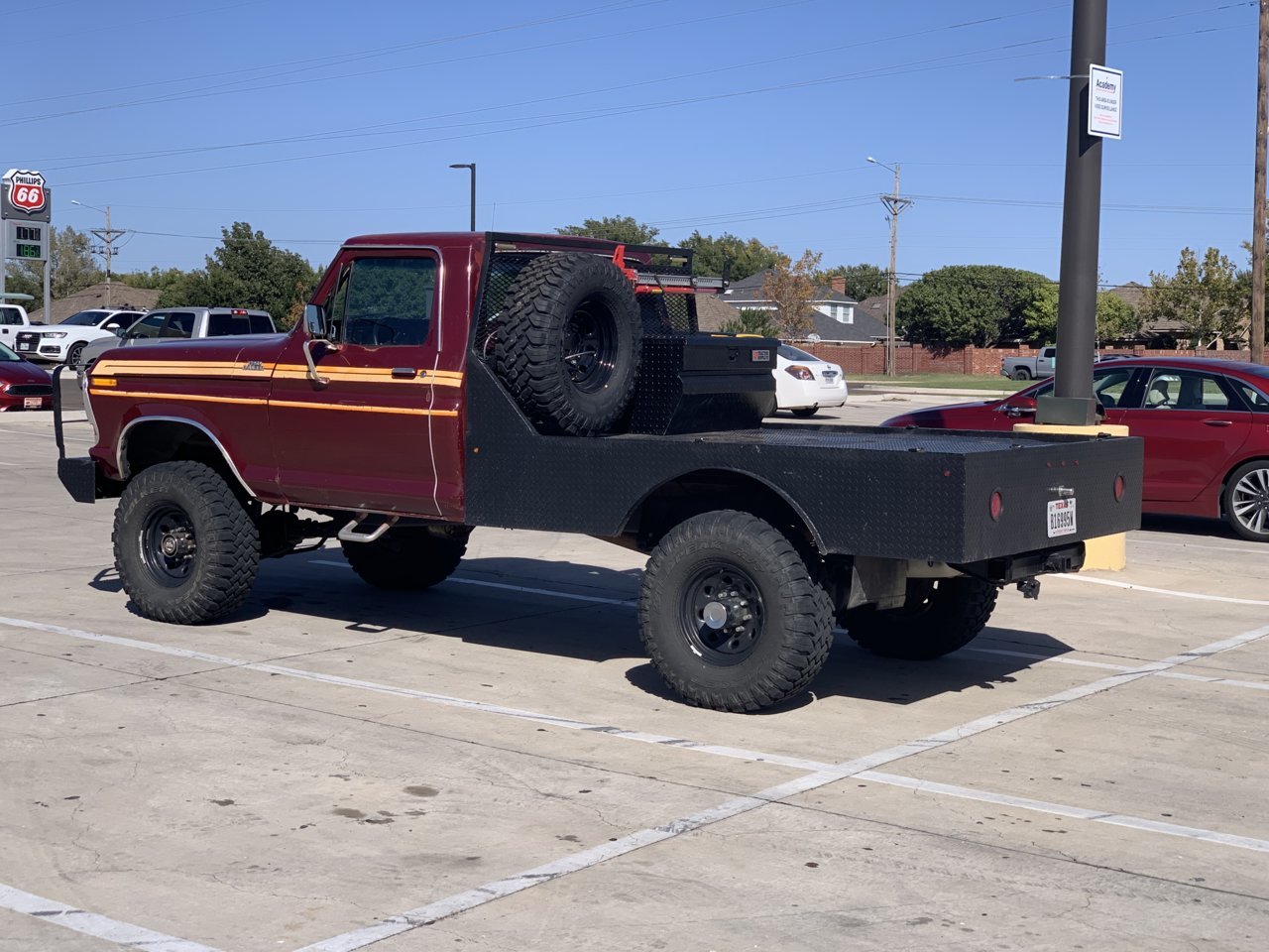

    I like the height on yours. I went with 881s just because I wanted Dakars and I didn’t want to have a massive rake. I’m still hoping I don’t regret the amount of lift. I like how low this truck is. I have a 79 F250 for those jobs that require massive ground clearance and 460 cubes! I have 30” to the bottom of the door.

    Got the rear leafs installed. Not too much fun to do alone but I got it. Hopefully a couple hours tomorrow to get the rear buttoned up and swap out the front coils and struts and then I’ll get to enjoy the truck for a while.

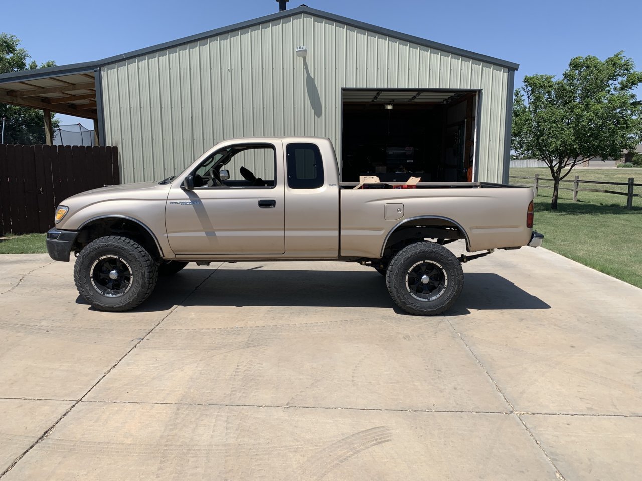

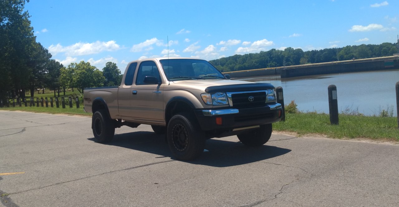

    Done! 25” hub to wheel arch on the back and 23” front. I bet when the Dakars settle it’ll be minimal rake. Haven’t driven it yet.

    looks good! Yeah it’ll settle a little bit but the front will settle too.

    what did you end up doing for the front lift?

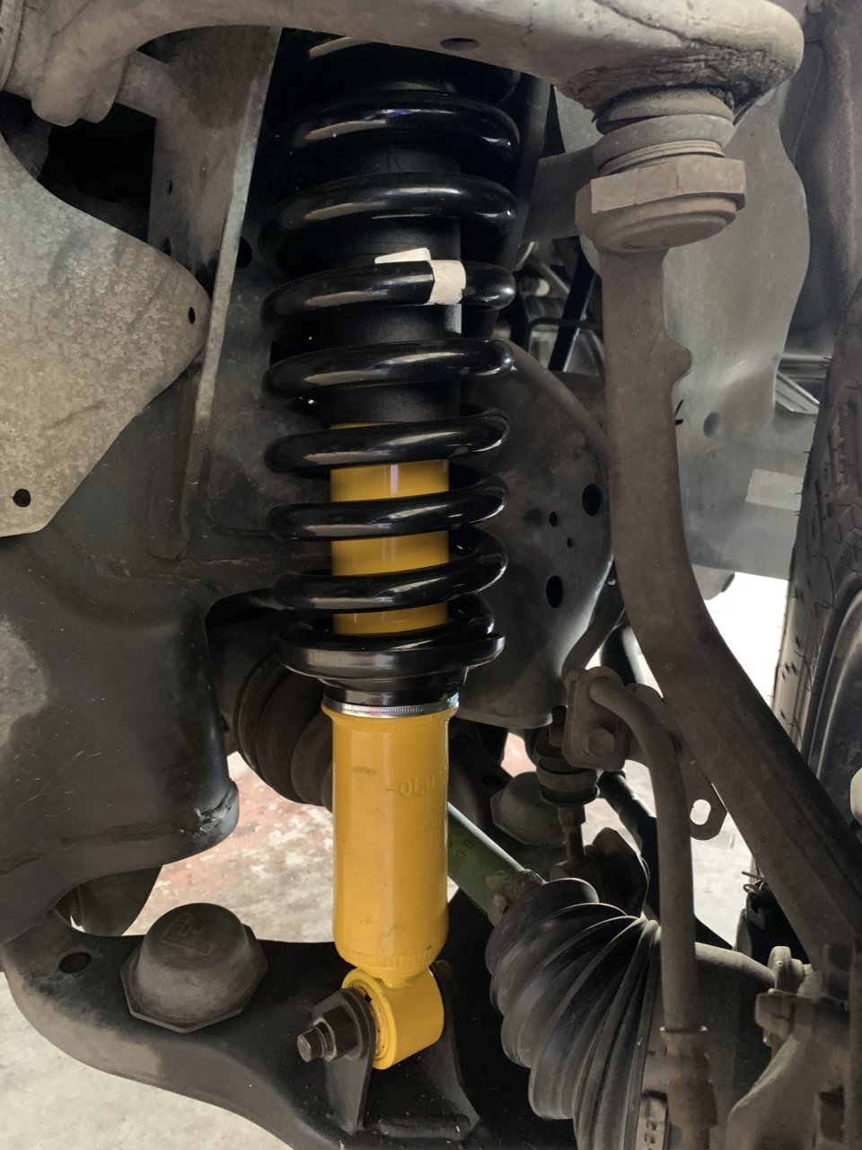

    881 coils with nitro chargers and a trim packer on the driver side.

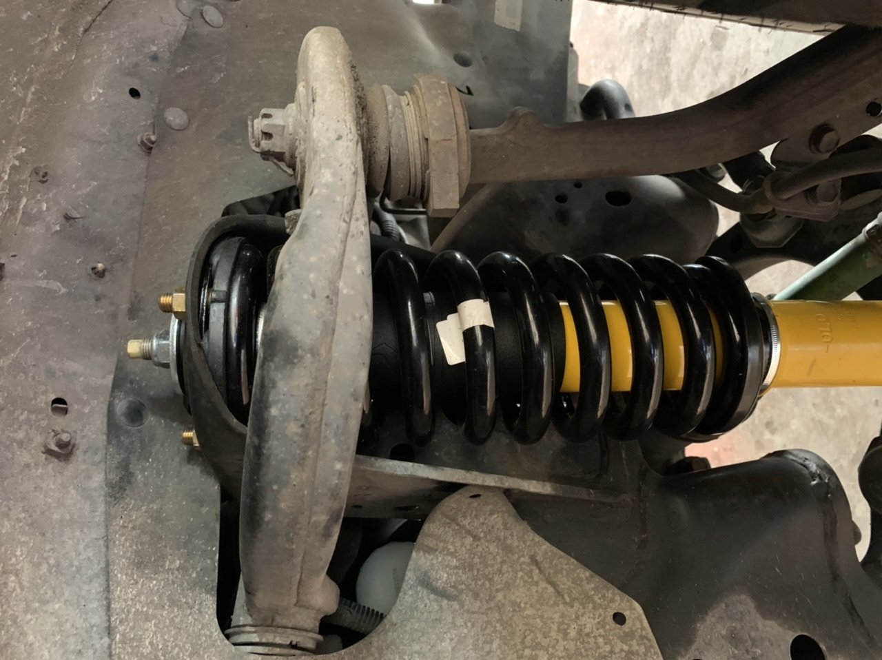

    can you post a picture of the drivers side front suspension up close?

    the shock, spring and spacer pack

    You can see the trim packer below the spring. It’s the silver part. The passenger side doesn’t have it.
