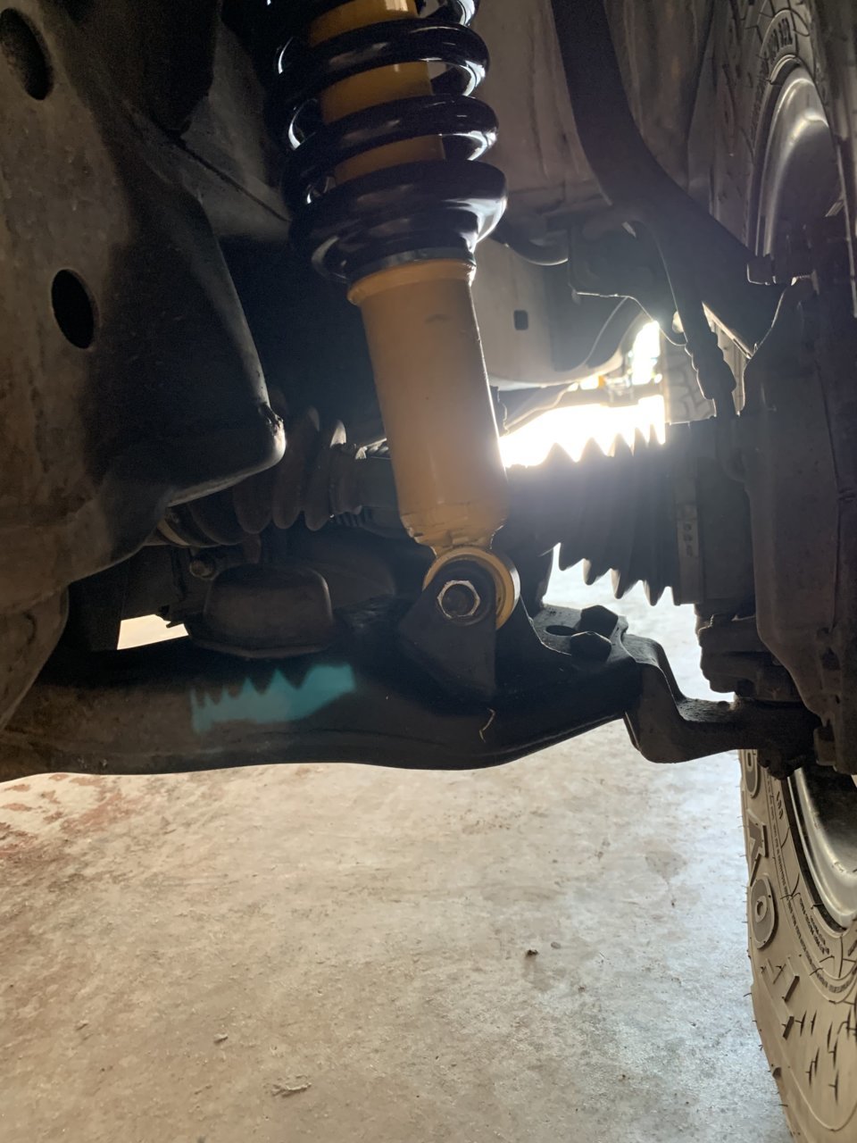

    Here’s my CV angle. Looks just fine.

    Yup. Cv just fine.
