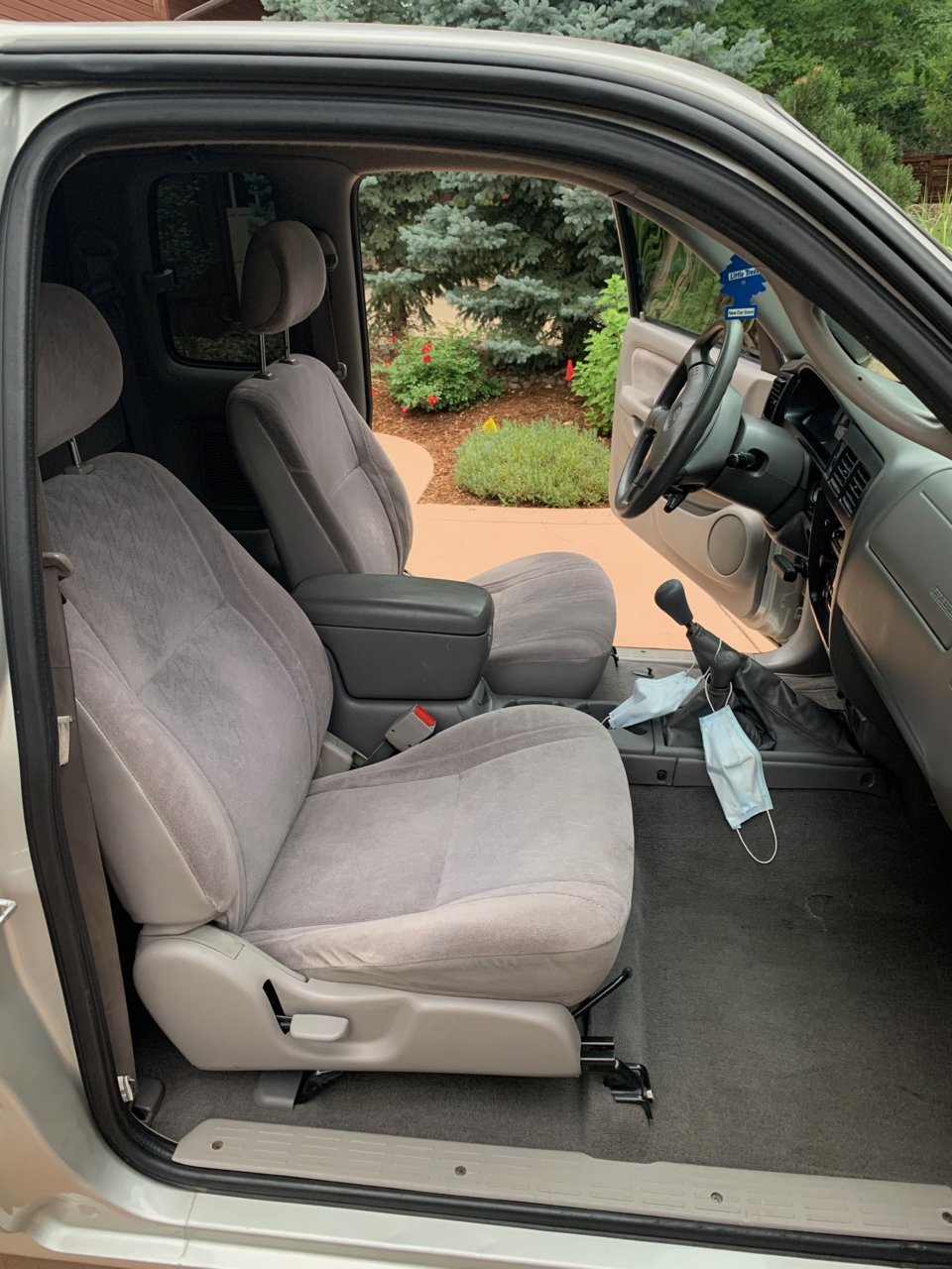

    I just wanted to thank everyone for the warm welcome and for the tips and suggestions about ABS. Per a couple suggestions it looks like this car never had it. I've owned a few Frankenstein's in may day and it's always a challenge to untangle someone else's ball of yarn.
    FWIW we disassembled the interior and gave the carpet a good power wash:

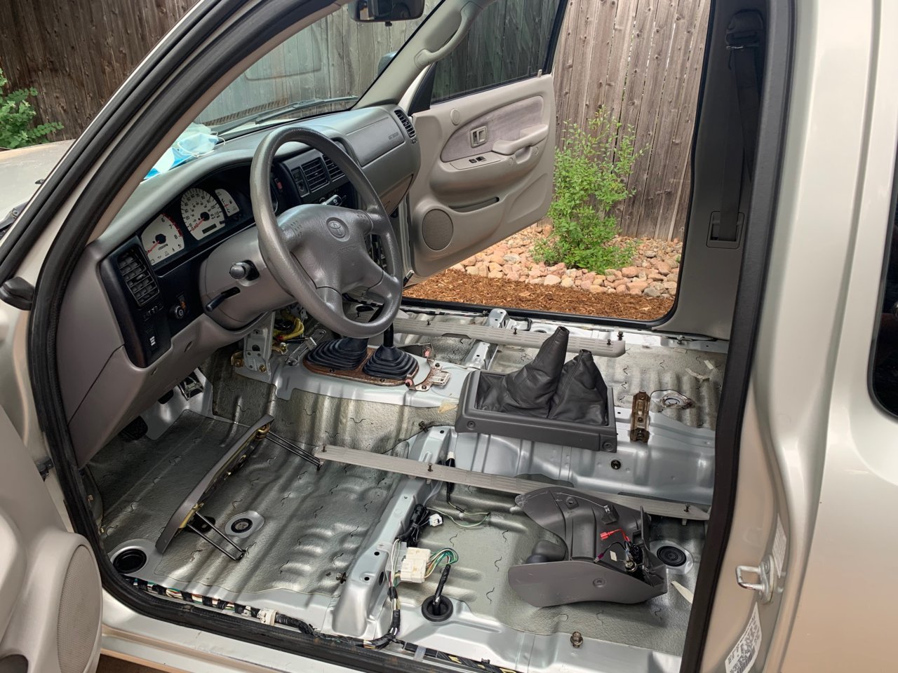

    How well did that carpet clean up and how much of a PITA was it to get the carpet out?

    Getting the carpet out was pretty easy and took ~30 mins. Basically you remove seats, door sills, seat belt anchor bolts, center armrest, storage bin rims, and rear jumper seats. There are 6 or 8 clips where the carpet attaches to the body: 2 near each door, then two in each of the storage bin cutouts. Mine had 2 velcro strips in the front footwells...which detaches easily. IIRC, you'll need 10mm, 12mm, and 14mm sockets and a Phillips/cross-point screwdriver.
    The carpet has padding in certain places; mine was tacked down to the body in a couple places with some type of glue which is easy to separate.
    Once I got the carpet out I hung it on a fence with some clips and went at it with a pressure washer for a half hour or so. The padding on the backside is going to get wet...but it dries pretty quickly. I used some vinegar in the pressure washer to eliminate old carpet stink. I also used a scrub brush for a couple stains and finished it off by pulling a squeegee down to pull all the water out.

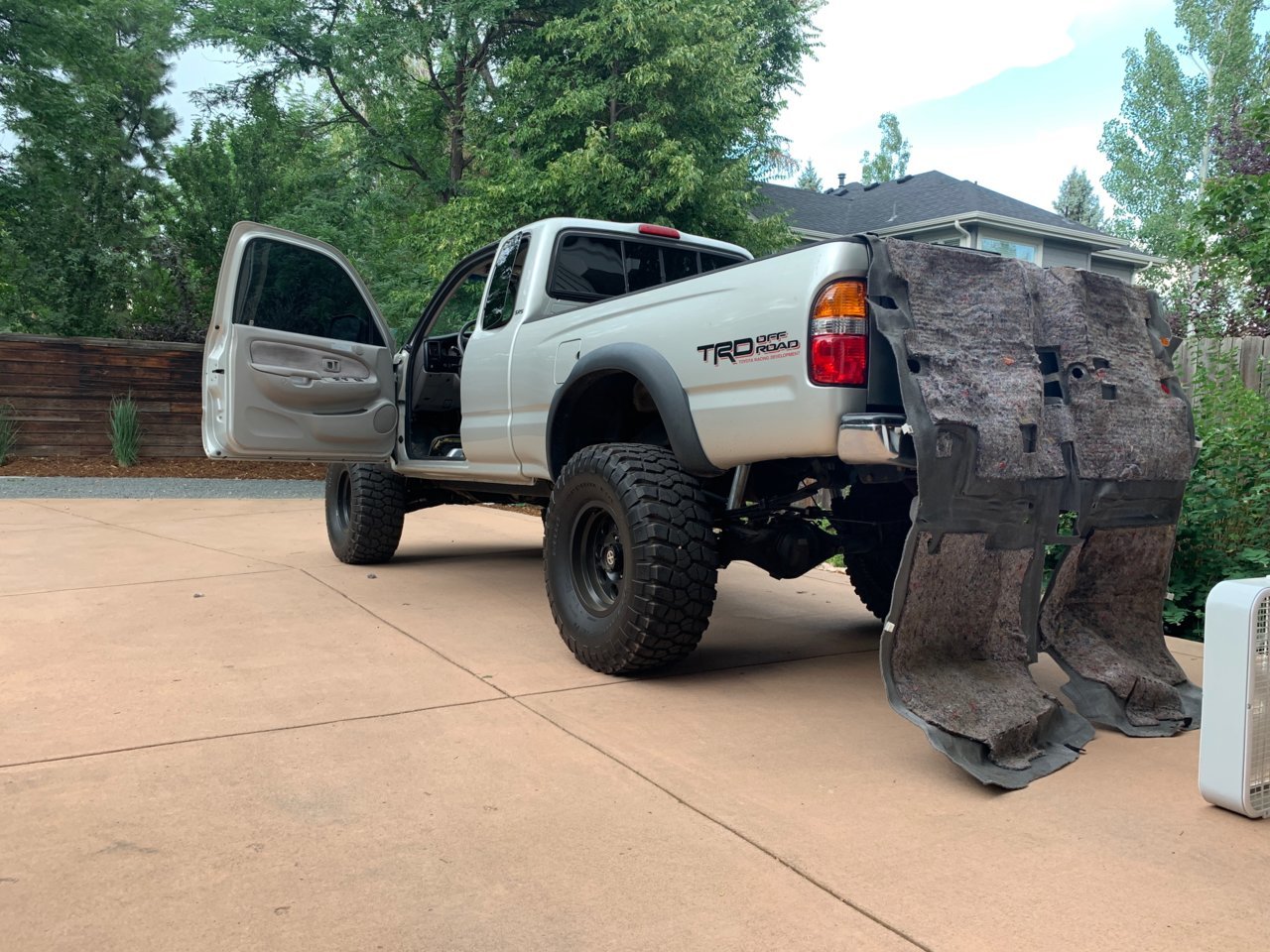

    Let the carpet drip dry on the fence...or hang it off the back of your truck in the sun as shown below. I had a fan going too since it was an oddly humid day here in CO.
    While the carpet was drying I gave the seats a good cleaning too.
    Once the carpet is dry--or even before you wash it--wack it from behind with a tennis racket or something. My carpet was full of sand, and flogging it with a racket was very satisfying. The carpet is molded in the shape of the body so it won't lie completely flat...but I also hit it with a vibrating head vacuum which seemed to help.
    My wife suggested spraying it with Fabreeze or something before we put it back in.
    My only regret while the carpet was out: I wish I had thought ahead and installed some sound deadening mat. Oh well, it was so easy to get the carpet out I wouldn't hesitate to do it all over again when I get some of that stuff.
    It was totally worth the effort IMO.
