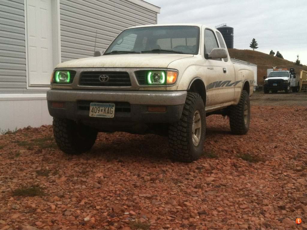

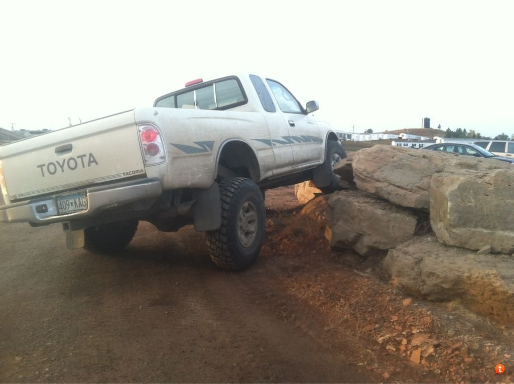

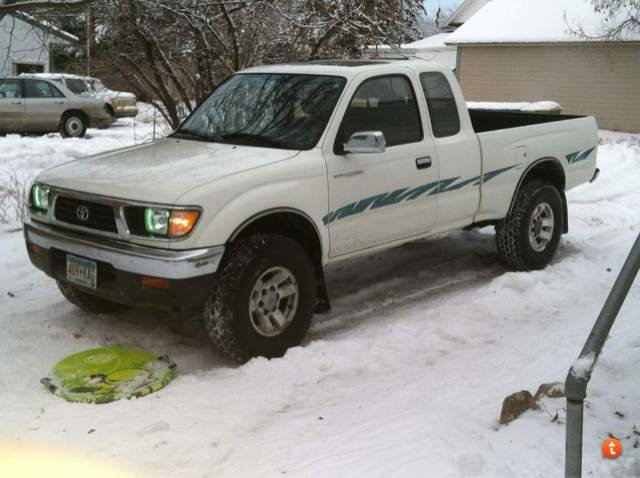

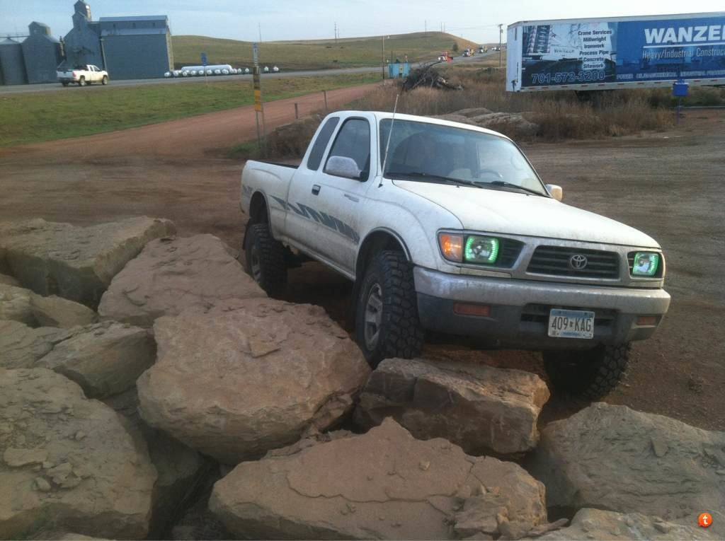

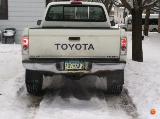

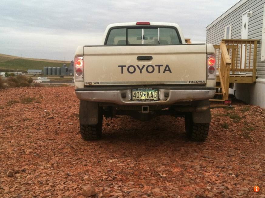

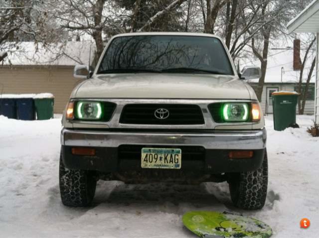

    3.5 fabtech suspension lift with dirt logic shocks, Wheelers Alcon 8 pack rear leafs with extended brake line All pro rock sliders Cbi DIY front bumper with m8000 winch Cbi bushmaster 1.0 non swing arm 33x10.5 BFG mud terrains Skid row front skid plate Trs headlight retro fit fxr 2.5in projectors with rbg halos Audio/electrical upgrades K2 73ah lithium battery Big 4 upgrade 300a Ohio generator alt Alpine type r 6.5 coaxials in front Alpine type s 6.5 coaxials in back Alpine double din touchscreen Digital designs z3 15” subwoofer Digital designs m4 amp Alpine ktp 445u behind the dash amp for speakers 152db
    Fabtech has a 0-3.5 inch lift looks great rides great little stiff but at speeds it handles bumbs and trails like a beast... I went with the dirt logic coilovers up front fully adjustable
    Before
    dyjesu4u_d14a145c9821ce814e28bf76a75f275cbb06462c.jpgju2ebeba_a06ff403f1090f0f2d20e740558c50f4469d2773.jpgytyrume9_40167c2d43bde9edddd7a7480b8f0b073acfff97.jpg
    After
    ezudu7a6_a3d908a9647e09581743113524b20e2b4bd22c91.jpgdetapame_a0d2c4df412cb861d9d84cf61646ec0243d1e92b.jpgnepudyze_586b47b23eefe15efd38b6ba03eae0e95b769da0.jpg7uruqynu_358ba6b52f40a00bae5062daf792bacc42c51f37.jpg
    Mine had the same issue when I purchased 2 years ago its been great ever since. Cheap 1500 dollar adjustable lift then throw some 33s on and she sits like that
