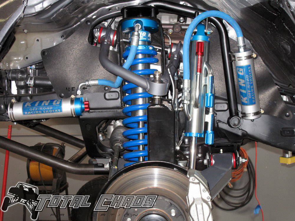

    Your best route, with out going with a lift kit is to keep at around 2.5".
    This will come down to how much you want to spend!
    For how you plan on using your truck, a Bilstein 5100 front and rear with a leaf pack in the rear is a good route.
    If you want to spend some more $$ and have the best, our Chase kit which includes our Boxed UCA paired with front and rear King 2.5's is the next best route!
    See the attached pictures and let me know!
    Thanks
    JT

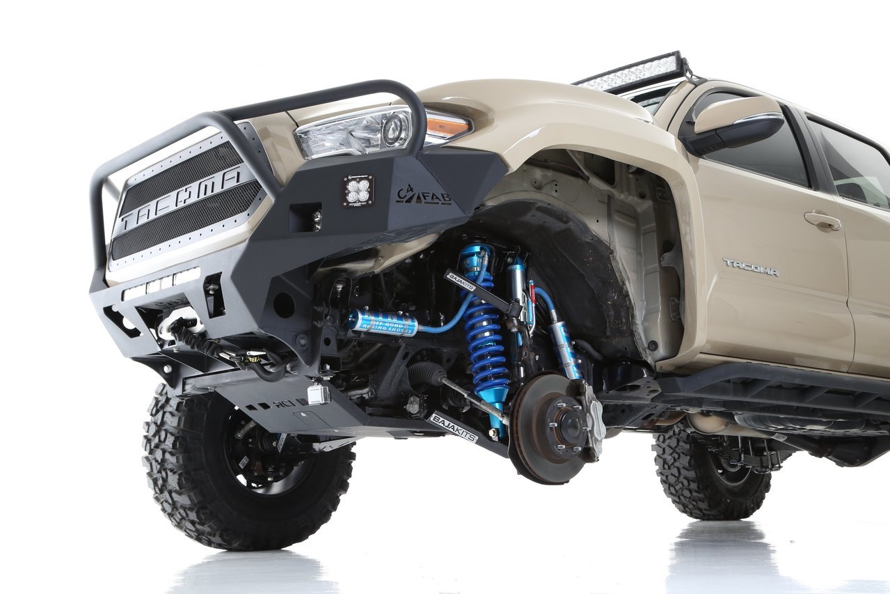

    Gotcha, FWIW if you’re looking at building a beast go long travel and get a double shock setup in the front with bypass which I’ll personally never need but will always dream of. Bajakits or any vendor on here could probably build you a legit suspension if you want to spend the cash. Again it’s me probably being biased since I’ve tested out Bilstein, Icons and now on Kings, but I would lean the Kings route since they’ve been in the game for awhile and have great customer relations. Here’s my dream suspension. Good luck OP!

    Hot damn that looks sexy. How much does a bypass like that typically cost?

    Your first born child.
    They start off around $1200 for a set of bypass shocks. The new 3.0 shocks for Kings just came out too and those alone for the front coilovers are $2600.

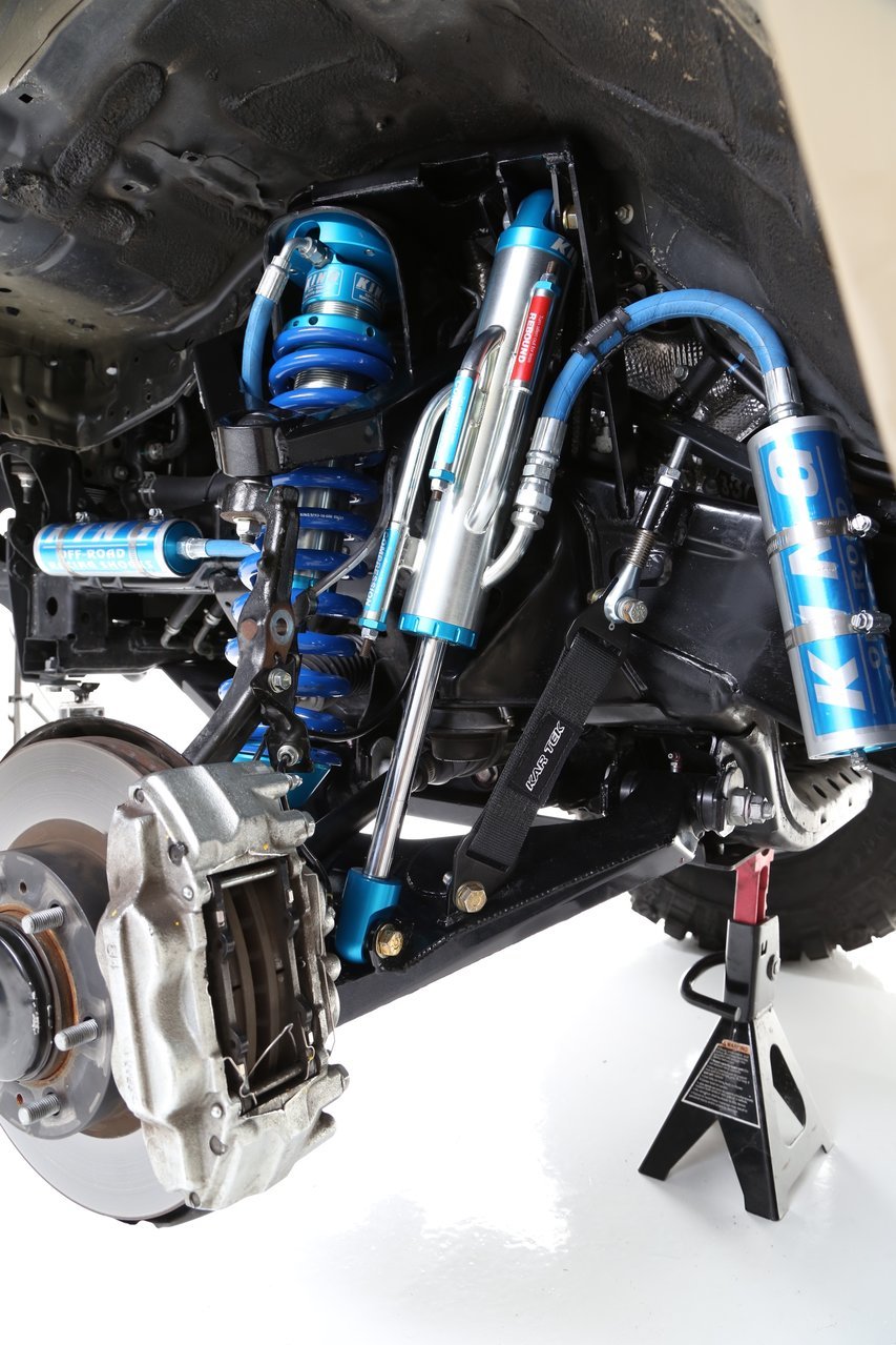

    The King 3.0 and bypass would be overkill for how you plan on using your truck but a Prerunner set up with a secondary bypass is bad ass!!
    In the end, just find out how much you really want to spend and go from there.
    I can definitely answer any questions you may have. We don't sell Bilstein or OME but can definitely direct you to some one who can. If you decide to go with King, i'm your guy! :D
    KrnTaco08 likes this.

    Thanks JT, i'll definitely let you know after I've finished my research and made a final decision.
    In what applications are the secondary bypass shocks actually used for and necessary?

    The secondary bypass is added so the coilover is not over worked.
    Mainly for off road use.
