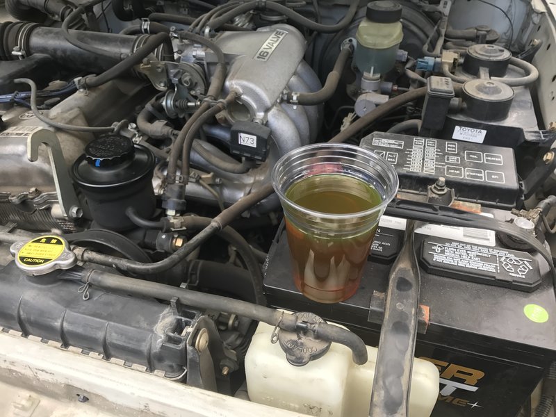

    This is after about 5k miles on new coolant. Any ideas what's going on?

    I would do another coolant flush and be sure to use Toyota red coolant. Looks like there may have been some leftover green coolant.

    Yeah certain places says it used the Asian red and other places say it takes the green. Not really sure what to think.
    Sad part is the picture I posted has green coolant so I am assuming I am getting rust from either the block or the radiator.

    I am a little worried about the coolant situation. Is the radiator able to rust? or only the block?

    The 3.4 is an aluminum block right? No rust

    Not sure. I have a 2.7L. I am not sure what can rust inside of the coolant track. Either something is rusting or gaskets are dissolving I suppose. The coolant turned from fresh green to dirty brownish within a 4 to 5 thousand miles.

    How do you completely drain the 2.7L cooling system? I seem to always have roughly a gallon in there after draining from the pet cock on the radiator. Running distilled water through my system a few times to try to flush everything before adding the Toyota Red coolant.
