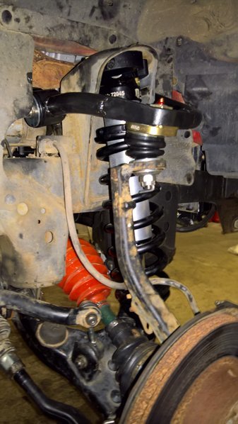

    Which ball joints? Uppers or lowers? I'm going to guess uppers. With a lift, they can get at a very extreme angle. You may consider aftermarket upper control arms to alleviate this problem. I just installed LR UCA'S on a customers truck. They did not have the extreme angle as the stock did. See pic.
