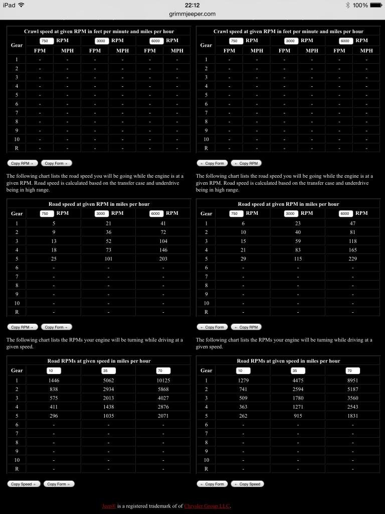

  12. Mar 4, 2015 at 8:20 PM
    Brjw
    Brjw Well-Known Member
    Dec 6, 2014
    #143769
    270
    Brian
    Forest Grove, Oregon
    Some numbers from a calculator.
    First pic, left side is 3.73 gears, 30.5" tires (numbers are dead on with my new sr5). Right side is 4.56 gears and 34.5" tires. Both automatic.
    In the second pic, the right side is 3.73 gears and 34.5" tires.
    Using a calculator here... http://www.grimmjeeper.com/gears.html
    For reference, if I had the numbers right last I checked, the manual trans on 30.5" tires puts you at 2447 rpm at 70mph. Maybe someone can verify.
