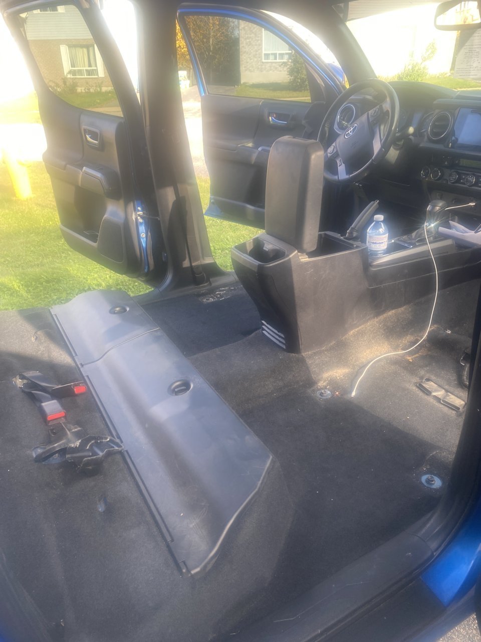

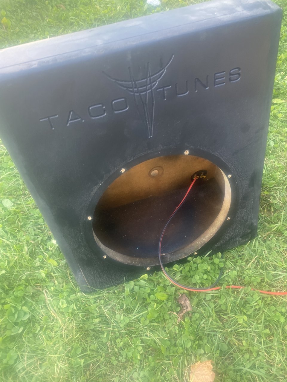

    Now I wanted to find out where that smell was coming from so I proceeded to clean the interior. I started by removing the front seats so I could give the carpet a good vacuum. I have since nearly completely removed the interior minus the dash and headliner. I removed toe centre console, and back seats including the under seat storage boxes. I also found an aftermarket (taco tunes) speaker box and amp behind the rear seats. When I removed the sub box, I found it to be severely water damaged so that has since been tossed. I'll have to fabricate a new box for it once I address the big issue.

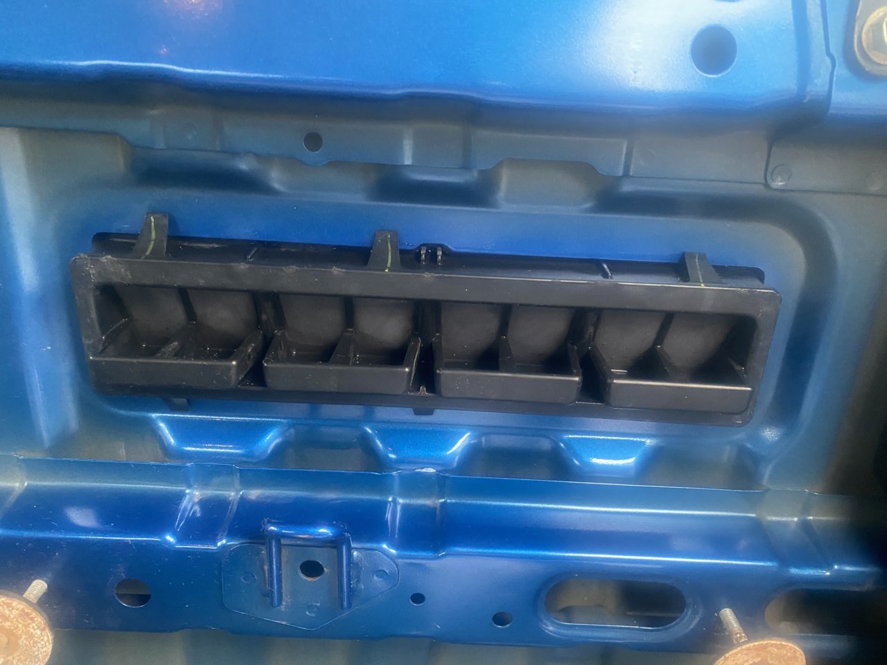

    Yes the big issue. I have a couple water leaks in the rear of the truck. The centre brake light and the cab vents are leaking. I put windshield urethane on the light and reinstalled it (all fixed). I then tried to seal up the cab vents with flex seal (actually gorilla sealer but i forget the exact name of it) but the driver side continued to leak. I just now applied a generous amount of 3M marine caulking around the opening. I hope this solves my water leaking issues for good.

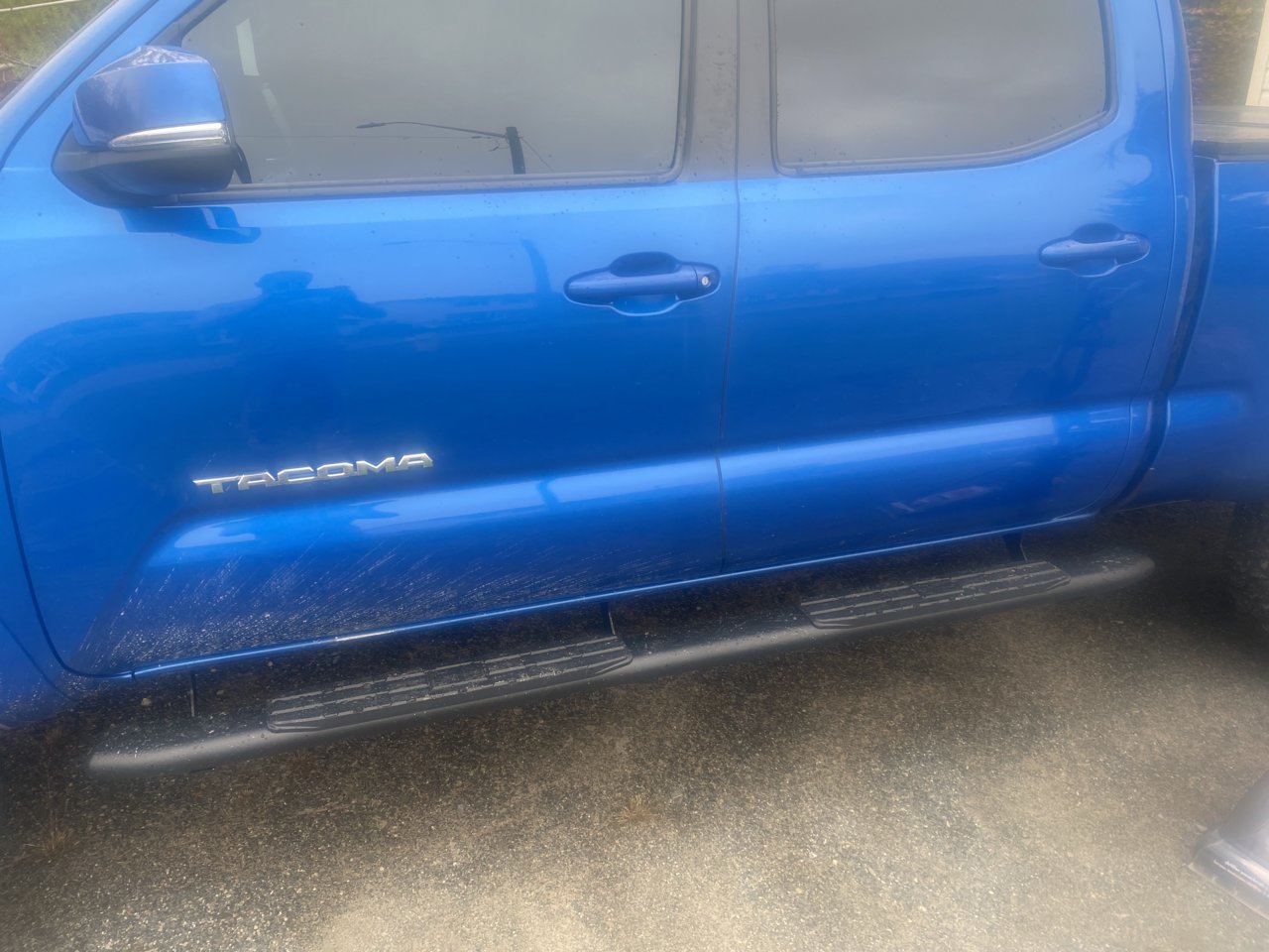

    I’m putting nerf bars (running boards) on today. Then cleaning the interior bits and seats.

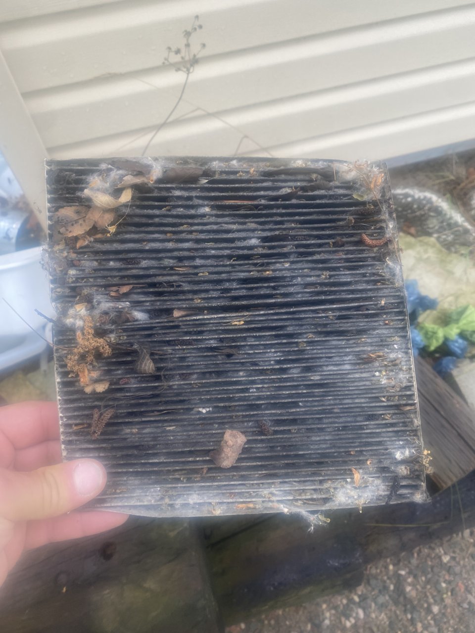

    I guess if they never cleaned it before, they would never change the cabin filter either! Lol

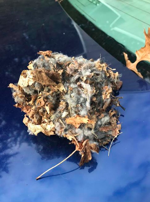

    My dad has an old used camry, changed his interior filter over the weekend and I pulled this ball of stuff out along with the dirty filter.
