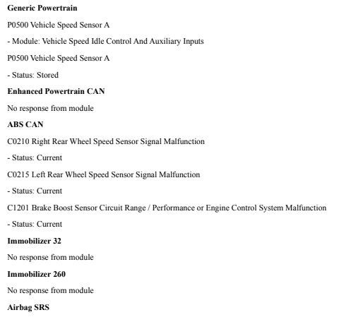

    This may not be incredibly accurate (for reasons I may have to explain later) but it's a current readout of codes I had/have.

    I think you need to check those sensors again
