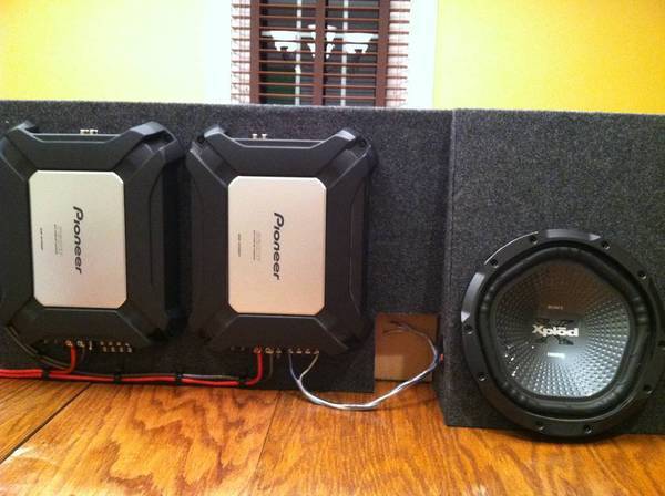

    Hey all. Picked up my 07 DCLB in December and have been lurking here ever since, thought it was time to sign up and post a few pics of my first mods.

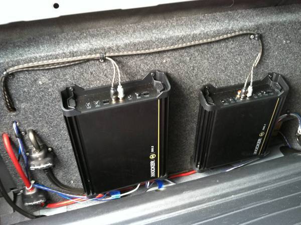

    I drive roughly 800 miles a month so the stock stereo had to go, I need quality sound and entertainment to keep from losing my mind on the road. Have been amassing parts for the last month or so and actually sat down and mounted the amps today. If it ever warms up here in NY I will get outside and work on running some speaker wire and actually putting all this into the truck.
    I am still waiting on the iphone cable and raam mat.
    I had the sony sub from my old truck and will put it in and see how it sounds but I will probably end up getting something else. Does anyone have any suggestions for 10" sub? 400w RMS, .85 cu. ft. and a 5" mounting depth. Would like to stay around 150.00. Thanks.

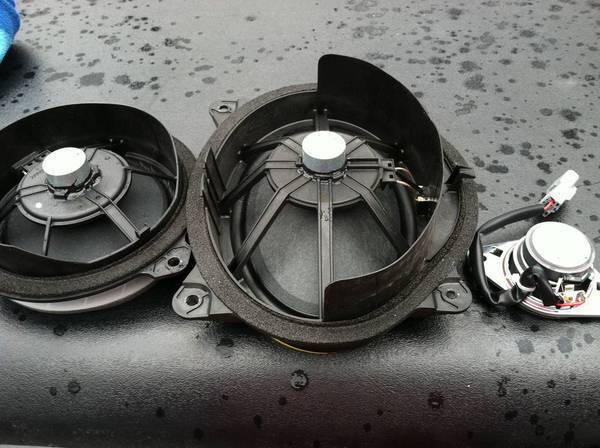

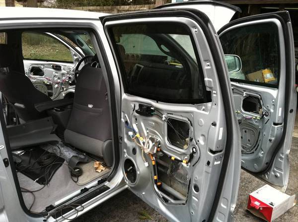

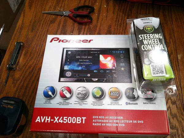

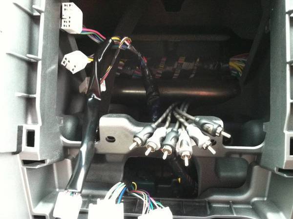

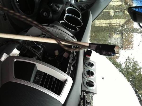

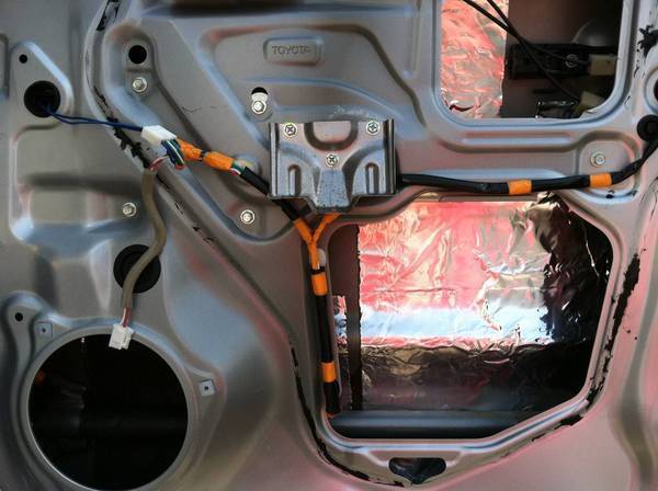

    I took out the rear seats and all the neccesary trim pieces, I probably could have worked around some of it but it was much better with it out. I got the power, RCA, and speaker wires all run. The biggest PIA was running the speaker wires through the door boots, I found an easy way to do it though however I was on door #4. Installed the raam mat on the inside door skins. Soldered up my HU harness with the ASWC-1 and the parking brake bypass and tested it all out. To my surprise the ASWC only took about 30 seconds to auto program and the controls work perfectly. Very happy about that as I have read some horror stories about that thing.
    Not much room to run anything back there but I got it done with the help of a bendy stick.
    The stick! Its actually a piece of one of those reflectors you line your driveway with so the plow guy doesn't dig up your lawn.
    Raamat installed on inside door skins and back wall. Once I get speakers in I will seal the doors with the mat and then cover with the ensolite. I bought some roof flashing and will seal the big holes in the door before I put the mat over everything. It is kind of an extra step but as long as everything is ripped apart I figure it wont hurt to try and seal the doors up as much as possible. The raamat seems like a really nice product and is easy to work with.
    The stock speakers and there laughable magnets, they need an enhancement product! It really is laughable. How can the magnet on the tweeter be bigger than the 6x9's?

    Got everything hooked up and running yesterday only to discover a channel on the 4ch amp is out. Great. At first I was pissed but then took it as a sign I should upgrade. Got some new goodies on the way, pics when the FedEx guy shows up.

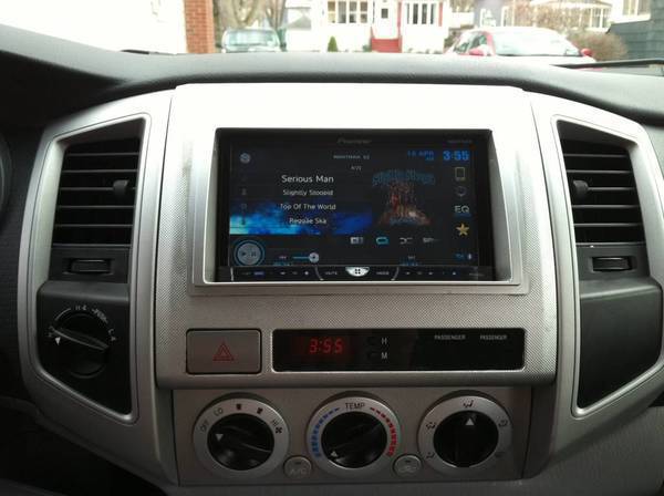

    Got the head unit put in. Went in fine, looks good. Works great, love the features.
    Seeing I had I a bad channel on my Pioneer 4 channel amp and I realized the pioneers were junk I upgraded.
