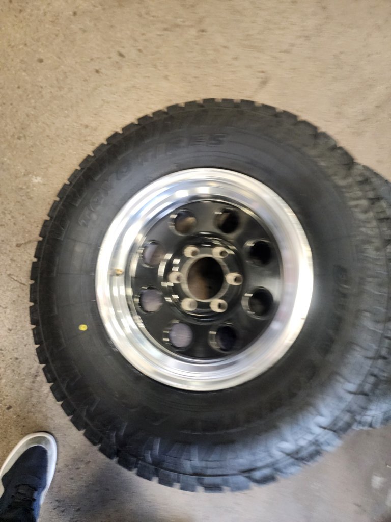

    Original 16x7 wheel ok with 265 70 16 tires
    ISSUE BELOW
    Moving to or attempting to move to
    MB mag wheels 16x8.5 and 265 75 16 tires

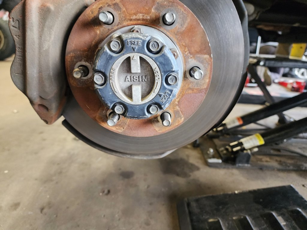

    ISSUE WHEEL WILL NOT GO OVER THE FRONT MANUAL LOCKING HUBS FLUSH TO FACE OF ROTOR – will not properly mount
    only get to the small rear set of nuts on front of hub
    Rears were fit ok/fine.
    BEST RESOLUTION OR REMEDY FOR THIS ISSUE?
    Wheel spacer grind center wheel and how deep a spacer 1/4" or 1/2"?
    anybody been there before?
    is a 1" space enough to get over factory stud
