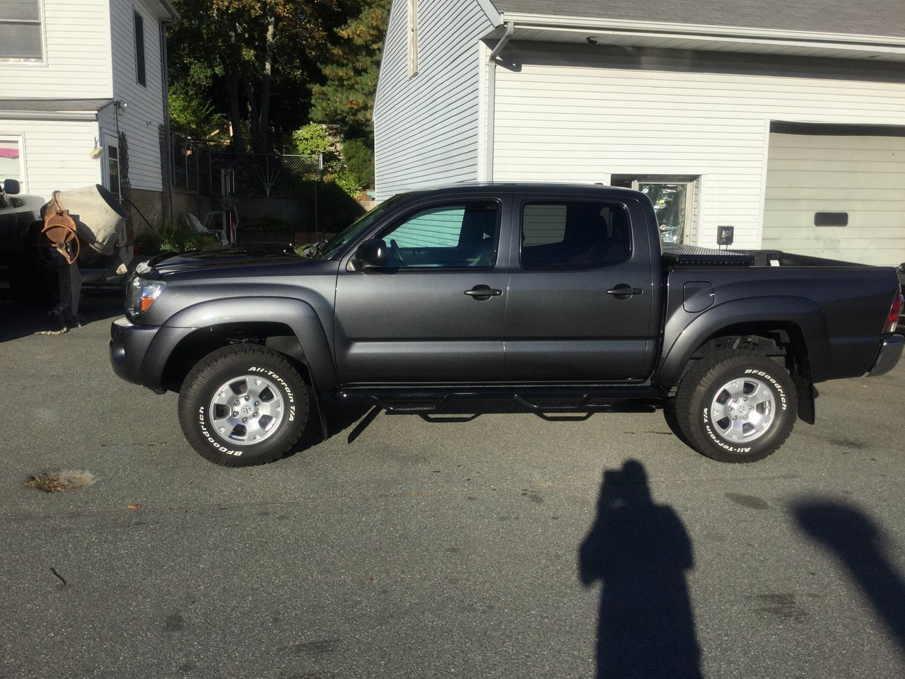

    2009 dcsb off road as it currently sits:
    Thanks for any responses.
