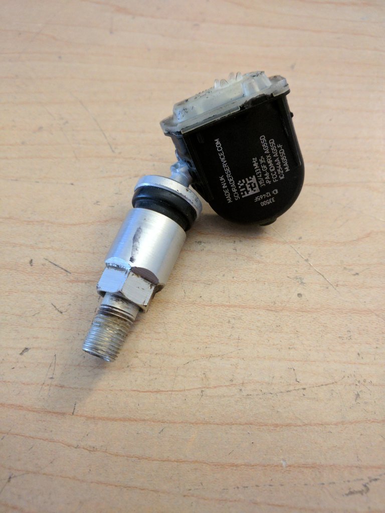

    Traded/sold my OEM OR wheels to my neighbor and he gave me his OEM sport wheels (both 3rd gen).
    A Toyota dealership quoted him 250 bucks to reprogram my old wheels' TPMS to register to his truck. Basically 2 hours of labor to take the tires off to get the ID. Seems like BS.
    Has anyone swapped over different TPMS at home? The only other thing I can think of is taking all 4 off his truck, deflating the tires, breaking the bead and getting the code manually. We would still have to either pay Toyota to reprogram or purchase that tool.
    Thoughts?

    Complete BS. They can use a reader, just like you could:
    https://www.amazon.com/Autel-TS401-Activation-MX-sensor-Programming/dp/B00AERMVYC
    And, they have Techstream to do the programming, just like you could:
    https://www.tacomaworld.com/threads/setup-tpms-sensors-cheaply-using-tis.397820
    GarlicFarts, yub and shakerhood like this.

    Take it to a tire shop and have them swap the sensors. Mine had no problems getting the tpms out of my OR wheels and swapping them into my Pro wheels.

    $2/ea. because I had them put in regular schrader valves in the old wheels.

    There are two things that you need to do.
    First is to get the ID numbers of the sensors. You can dismount and read the number printed on the sensors or use a tool like the one mentioned above. Any tire shop should have one of these tools.
    Second step is to program those new ID numbers into your truck's ECU. For do-it-yourself, the best option is probably the ATEQ Quickset tool. https://www.amazon.com/ATEQ-QuickSe...coding=UTF8&psc=1&refRID=2Z110B4HKBSG5WRDR7HB
    Dealer can do it with Tech Stream or a tire shop that has a programming tool.

    This is what I used and it worked perfectly.

    $260 is what Toyota of Puente Hills quoted me. Got it done at Firestone for $19.99. No need to get the codes manually as a reader can retrieve them.

    I just swapped mine around in my driveway. Used a high lift jack to break the bead and air compressor to reset the bead. Took about an hour including me looking up one sensor to make sure that half of it wasn't still in the tire.
