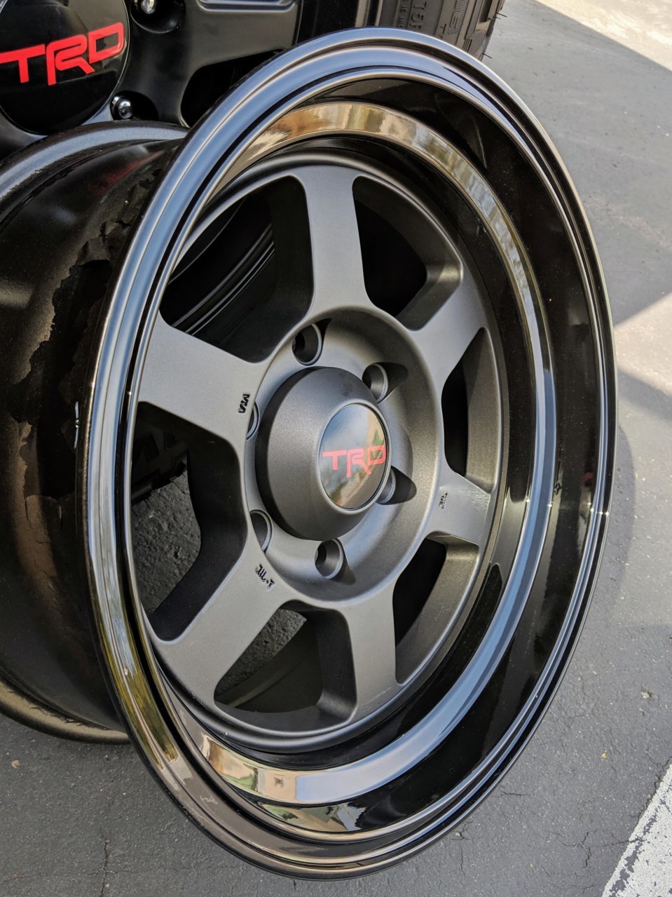

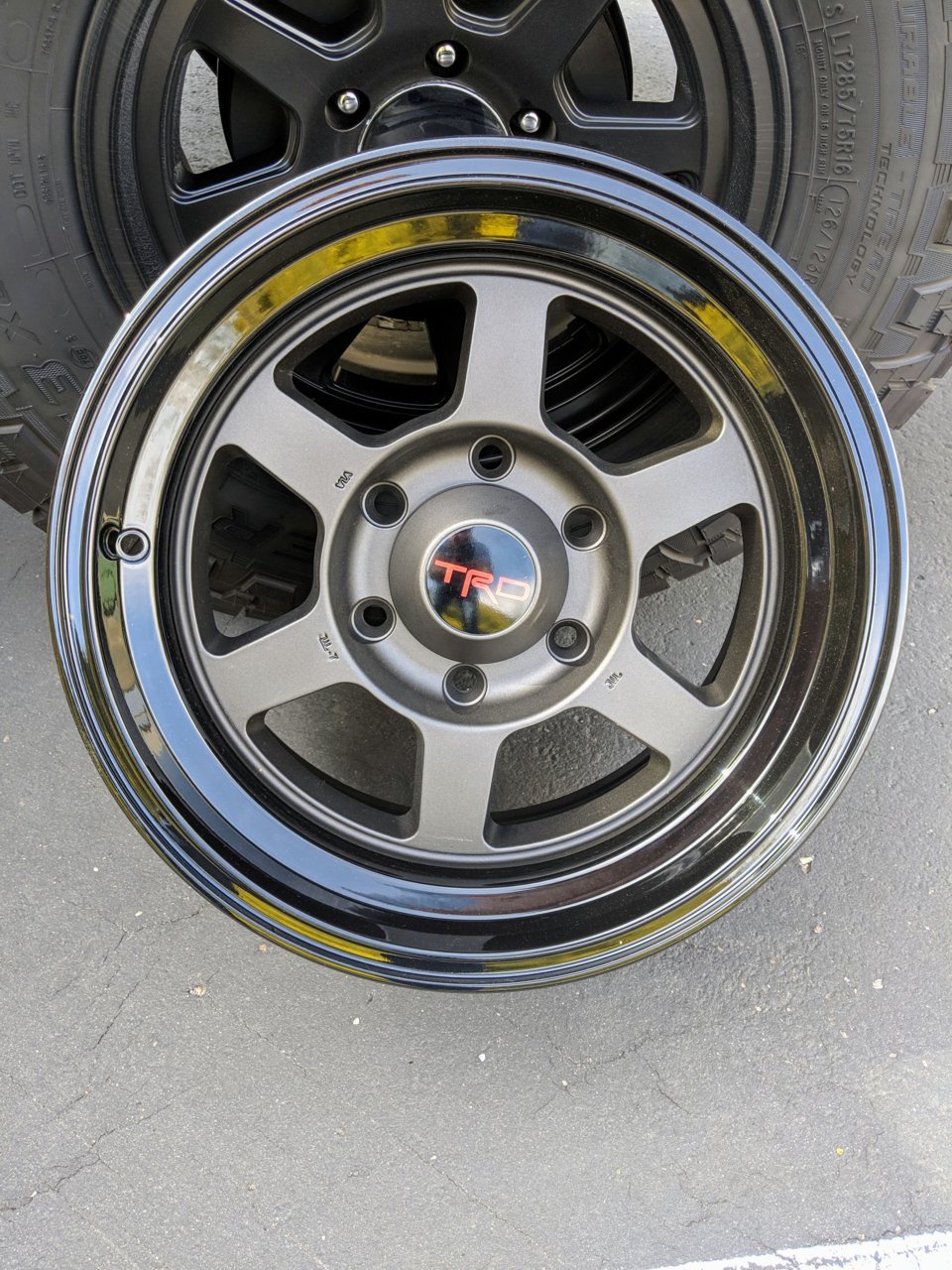

    Ordered these beauties. ROTA Grid X offroad 16x8 +5. Gunmetal face with black lip. I should have paid closer attention to the super flat face of the wheel. Most wheels concave out giving room for the brakes. These just scrape the front brakes very lightly when mounted.
    I really like them and I don't want to pay the restocking fee and return shipping so I ordered BORA .75" spacers instead. That will make the wheels a 16x8 -14mm, so pretty much like the SCS wheels.

    Seems like that spacer might still leave them a little too far inboard. Wouldn't you want a slightly positive offset if not zero?

    Positive offset = wheels closer to the frame.
    Negative offset = wheels farther from the frame.
    In a nutshell.

    Offset won't matter in this case, you are basically moving the entire inner face of the wheel away from the brake caliber.
    Edit by using spacers. An otherwise identical wheel with a different offset would still rub.

    Exactly. The .75" spacer (19mm) pushes the wheel further out (and out past the fenders) like a negative offset. So a 16x8 +5 becomes a 16x8 -14 with the spacer.

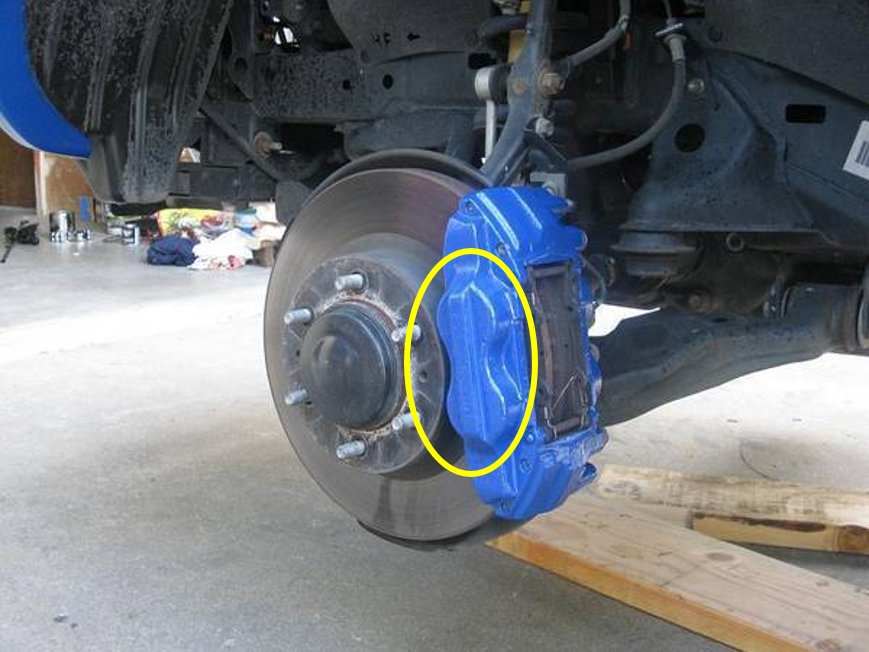

    Would grinding down the brake caliper be an option?
    nudavinci64 and 9TRDTCO like this.

    I thought about it briefly. It's that raised hump on the front face of the brake, but I just don't feel right about that. There's probably a cast hydraulic vein there.

    According to a post in this thread: https://www.tacomaworld.com/threads/grinding-the-brake-caliper.153662/
    It's a brace between the ears, but always proceed with caution. If it's 1-2 mm, then I would be comfortable grinding it down. Any more than that, then I would worry about comprising the brace.

    It's this raised section in the middle. I have a feeling it serves a purpose so I am not going to grind it.

    Houses the pistons. Def has a purpose. Good choice not to grind.
